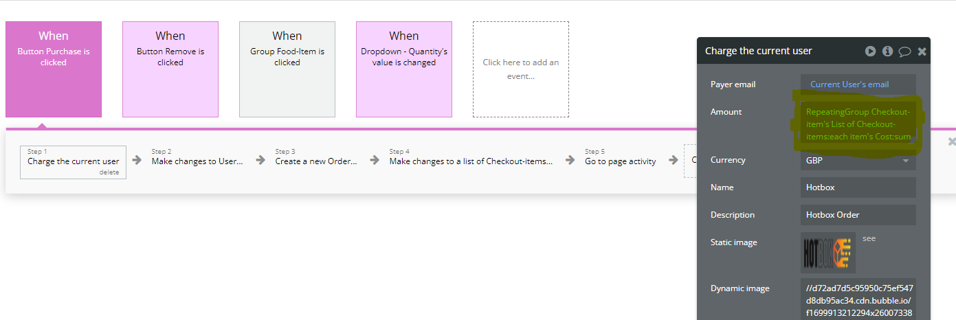

Here is the current checkout setup -

You could use two separate ‘Charge the current user’ blocks, and use conditionals to check whether the delivery radio button is active. One block will have the extra 4£, while the other wont.
I think this is a terrible way of doing things because it makes it much harder to maintain and you will quickly get swarmed with blocks if you have a lot of different combinations of possibilities.
This is a great place to use the :format as text operator.
Radio button is checked: format as text (If Yes: Base charge + delivery, If No: Base charge):converted to number
This allows you to use a single dynamic expression to correctly format the ‘Amount’ field.
It is really cool because you can also chain :format as text operators to check multiple conditions.

Just to confirm, would this be run on the same workflow as the purchase button as per the screenshot above?
My main question is, where does the delivery charge come from? How do i add this in? So when i add If yes: Order total + Delivery. but where does this value come from?
Thank you!
If all other steps are the same; you need to figure out, whether it include delivery charges or not.
Then: as @nico.dicagno suggested.
under the same workflow on button, in the charge the current user action on amount you can use
 Radio button value  is collection ( :format as text
> if Yes: base charge + delivery fee
> if No: Base Charge) :converted to number

I attempted this, but getting errors. Can you please assist.
Thank you
It’s wonderful, you error you get is because of maybe not understanding us. or maybe our English is poor to guide you on what to do exactly :smiley:
you don’t need to include if YES: or IF NO: … inside each each box for :format as text case. don’t also use the format as text inside the NO. we need it to be a number only. and as the value return in each case would be considered to be a text we need to make it a number.
after the main :format as text add a :convert to number
I have actually done this, please see here:
error i am getting is : invalid payment amount : null
