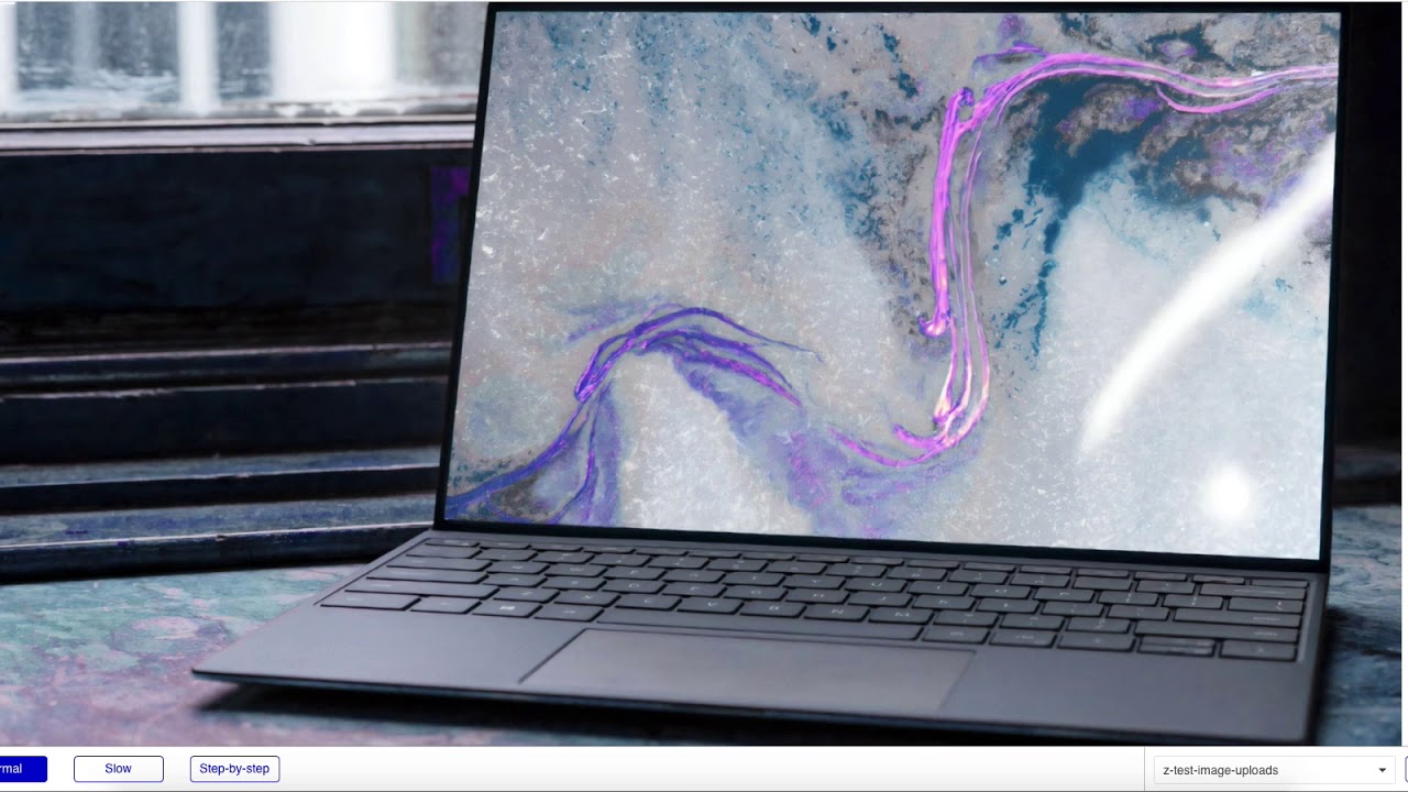

This is how I set it up
This set up is taking an uploaded file from my device, letting the user crop it, then save it, which then triggers the creation of a file in my file manager with a URL component. After that I use that URL to compress the image, after compression save it to the D.B. as a data type and finally deleted the file from the file manager.
The thing about this is that the file I delete from the file manager is not the same file that is saved to the D.B…in the D.B. the data type is saving the compressed image, but the file being deleted from the file manager is associated with cropped image.
I am still able to see the image in the D.B. and display it on page in an image element.
Is something going to cause a problem in the future? Would I realistically be able to save images in the D.B. and not have them take up storage capacity in my file manager?
Here is a Video of the setup in action
