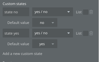

And if you want to use empty yes/no for search constraints just custom state list of yes/no’s ‘‘is in’’’ and add remove yes/no

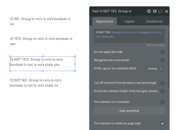

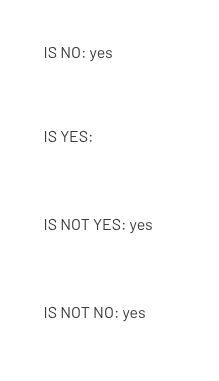

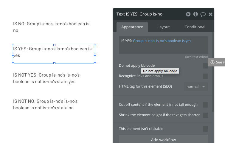

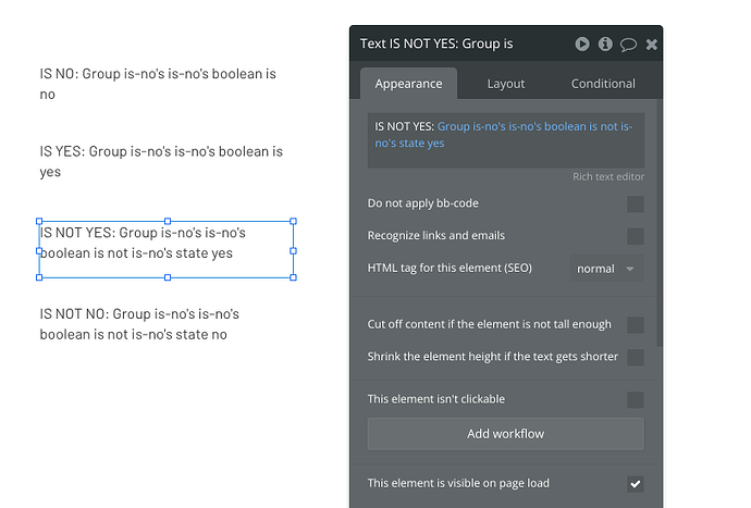

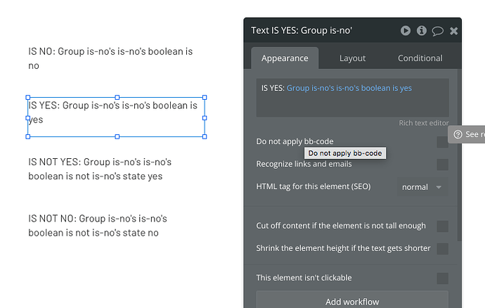

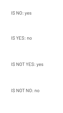

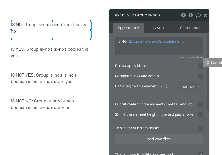

The default of a Yes/No field should be No if it is expected to be the default. And if you need to add one to an existing data set and would need to run a bulk update to populate the field value you should, because it is not the best idea to leave a blank field that is supposed to be understood as ‘no’ when in fact it simply is not in ALL potential use cases of how to filter values between yes or no as demonstrated in my screen shots.
We WANT THIS EVALUATION BELOW:
NOT THIS

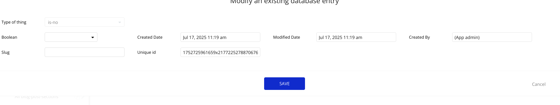

RANDO, Did you set any values to yes? If so how did you? If no, why not?
For some other reasons to not leave them blank for no, is that when you export your data as CSV or JSON the field value DOES NOT show as false, it shows as empty.
Remember, that False is not the same as Null and so an empty yes/no field is not the same as No.
