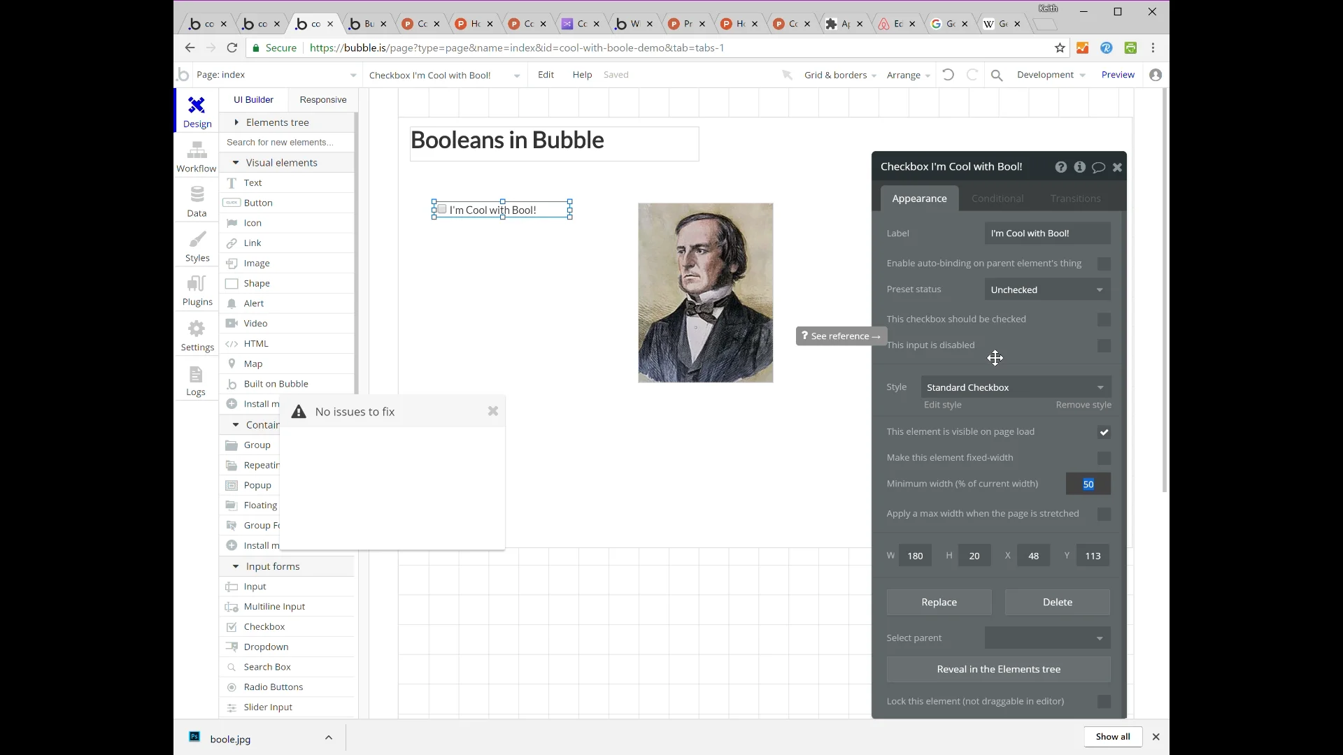

Why is there so much retro Boolean questioning this afternoon/evening? Might be old but surely still relevant:
Finallyyyy!! Thanks mate
Hey Diego, Im not seeing “option set” under my elements, where can I find that?
Option Sets are under ‘Data’ tab => ‘Option Sets’ on the submenu
oh okay, thank you!
Thank you keith, this video saved my life. I passed 3 hours trying to solve this
