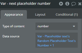

I stored the different texts in an Option Set
The next placeholder number is:
On the last entry in the option set, I set the next entry back to number 1:
