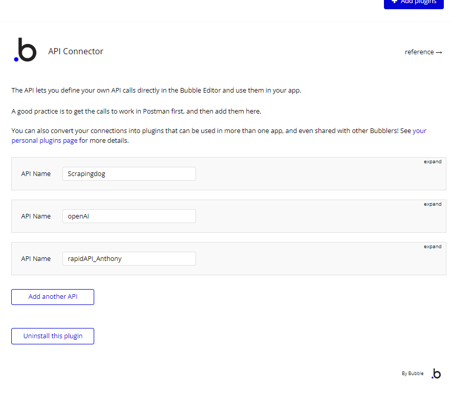

Hey Bubblers,
I’ve a similar issue. I’ve got 3 APIs configured, but only one of them is visible when I try to trigger an API within a workflow.
  1. Are they set to Action rather than data?
  2. Are they initialised?
Yes, I’ve set the type to Action and I’ve reinitialized it.
However, only one API is visible in the plugins. Does Bubble restrict users from using more than one API in a workflow?
If that’s true you should see them. Can you show screenshots of each API call? You can hide any API keys
Hey, it does work now :slight_smile:
I tried toggling the data type between JSON and text, and somehow, the APIs magically appeared.
Really appreciate the support!
