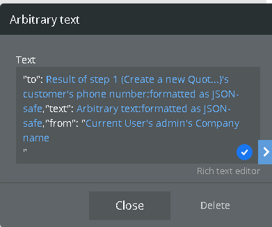

but just to be sure you mean like this right?
Yes! Do the same for company name too, as users could enter quotation marks or other JSON breaking characters there.
thank you very much.. that did the work :blush:
