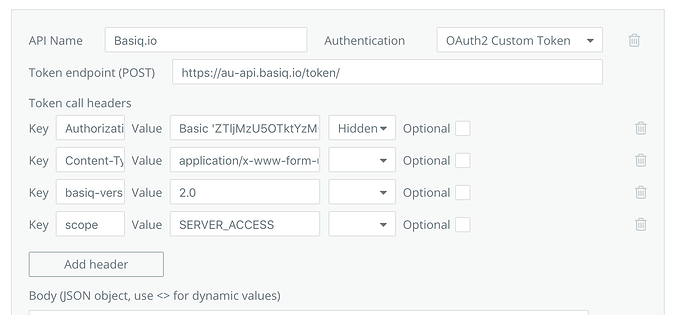

This is how I’ve got the API making the call, according to the API docs

Well i went over there to basiq to see there docs & there site was so basiq that apart from a few flags the site is showing errors in the console rather than a key. from a quick a look though give this a try…
Use Basic YOURKEY in the header value and if not try application/json as the content type…

Ok, that means that the ?scope=SERVER_ACCESS needs to come out and either go back in the header or more likely in the params section below with query string checkbox ticked, if you have a spare key PM me one and I will work it out for you.
