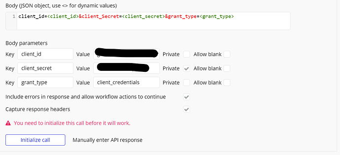

Hi, I am using an API that uses OAuth 2.0 and x-www-form-urlencoded. The API gives me a client_id (public), a client_secret (private), and grant_type called client_credentials to access the API. I first have to perform a post request that generates a token. Once I have the token I use it in a header
Key: Authorization Value: Bearer {{token}}
I have tried variations of all the OAuth 2.0 options provided by bubble.
Here is my current attempt:

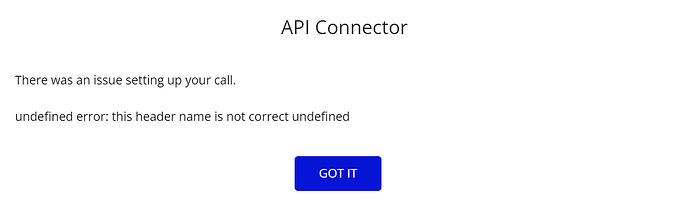

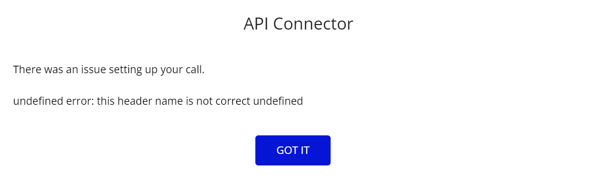

I have also tried having the key be ‘None or self handled’ and then doing an API call to get the token:
When I attempt to initialize this call I get the response:
I think the right way to do it is a post call to get the token → use the call in a workflow and get the token → use ‘result of step x’ in another workflow to do other calls.
This works easily in postman so I know its possible. I have done normal auth key JSON calls before but the ‘application/x-www-form-urlencoded’ is really throwing me off. Any ideas would be greatly appreciated.

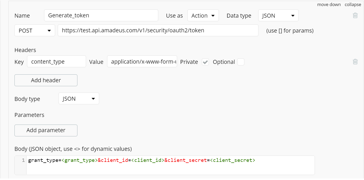

Try Content-Type not Content_Type
Make sure you check your parameters as querystring
Thank you for the suggestion @doug.burden and @johnny , I tried both of them but no luck so far.

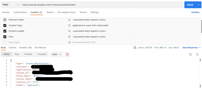

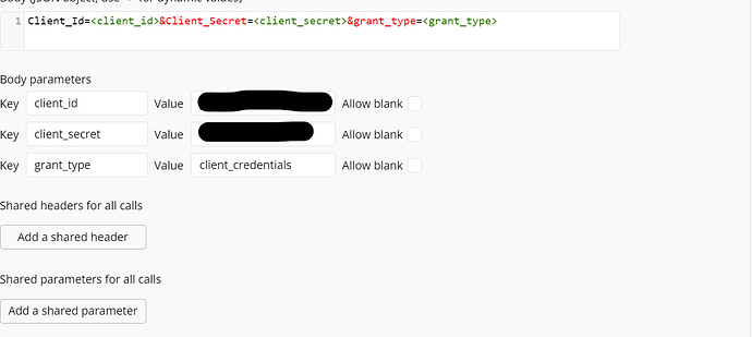

I have tried to copy the postman(which works) into bubble api connector(doesn’t work)
Im going to put screenshots of the postman vs the bubble api connector please let me know if you have any ideas!
Bubble:

Postman:
Headers and response:
Body:
Params(none):
I think that I may have to turn the body into parameters? but I have tried various ways.
The Bubble part is set up to what I think is copying the postman exactly but no luck.

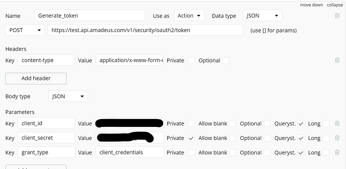

Nawl big dawg. Remove the body and just make them parameters, checked querystring
Thanks for replying @doug.burden ! I just did that but it still doesn’t work, am I doing something wrong?

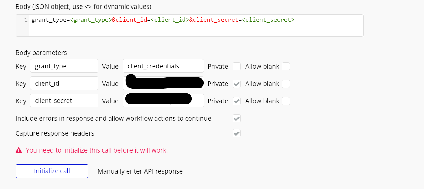

Parameter
grant_type
in the value for grant_type use “client_credentials&client_id=someones_client_id&client_secret=someones_client_secret”

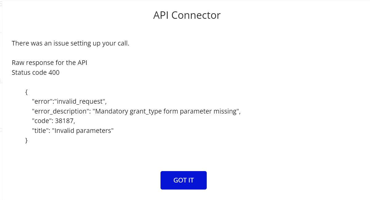

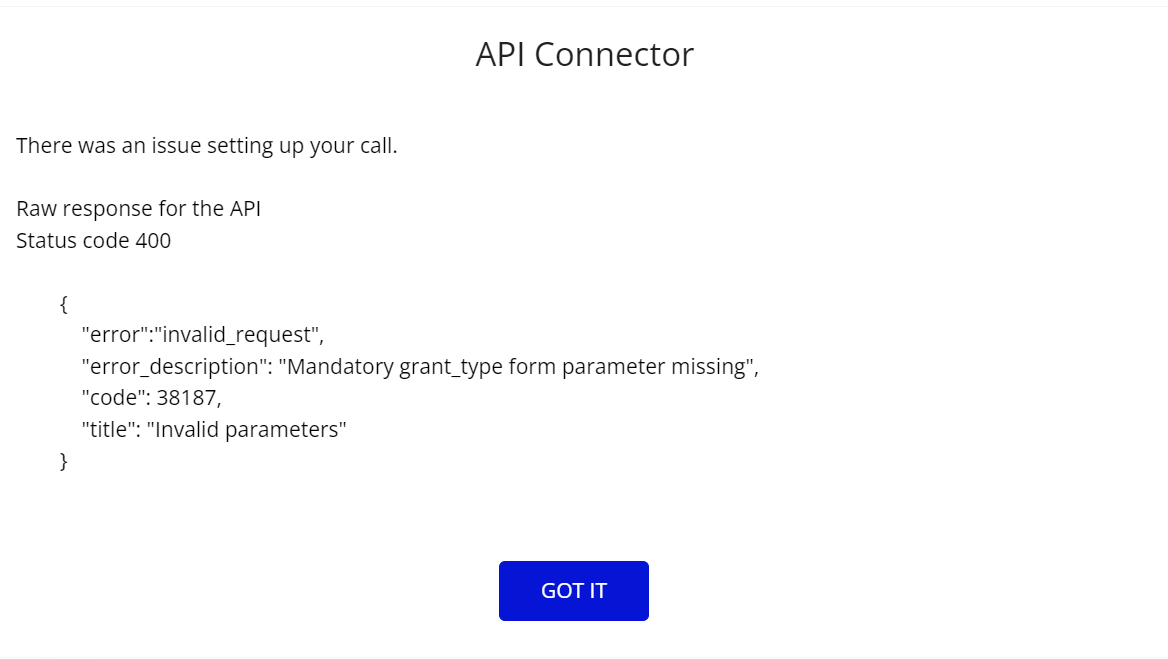

Ok I did that while replacing the client id, etc. but got new response that says grant_type is wrong. Thanks for all your help really appreciated!!

For my OCD can you make your content-type Content-Type
Same Response as last time :frowning:
Yea I didn’t expect a different result, just had my eye ticking
3 params, all querystring
grant_type
client_id
client_secret
what error do you get when you do this
Same response when 3 params
