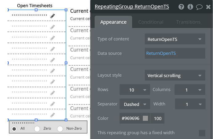

I load a list of records into a RG from the SQL API, not problem. I have radio buttons to allow the user to filter on a field that holds a numeric value (Hours), so they can have the RG only display a subset of the records already displayed in the RG. I have a workflow set for when the value of the Radio Buttons change. I am using the ‘Display List’ workflow and setting the filter for the RG in there, referencing the RG list. But nothing seems to happen. The RG does not refresh and displays the same records no matter what I select in the radio buttons. Any help would be appreciated. Thanks.

I call a SQL stored procedure using the SQL API Connector that returns All the records. I thought I could just filter the resultset in Bubble based on the radio button choices. But that did not work. I tried using the :Filter command as I showed in the original post, but that did nothing.

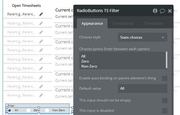

The radio buttons are set up as:
So only the “All” option works. Hey @emmanuel, is it possible to filter data returned by the SQL Connector?
