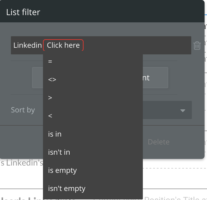

Thanks, Emmanuel. I had tried :filtered and numerous other paths that seemed close to working but would not take, even when they seemed that they should/would. For example, in this screenshot, I would have expected the “'s” + LinkedIn API fields to appear here as they do most other places I see the LinkedIn variable, but they’re absent from the list (as are all of the other “'s” options):

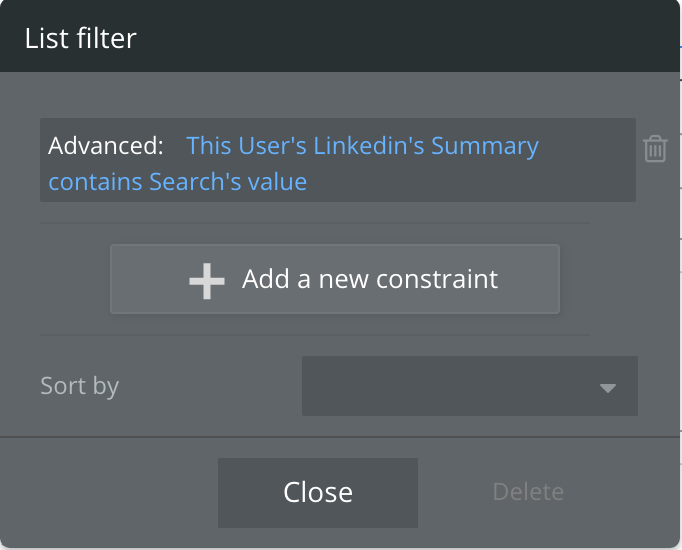

I do believe I finally figured it out using the “Advanced” filter shown here:
… where I’m assuming “This User” refers to each User row in the repeating group being searched/filtered (as opposed to the “Current User” conducting said search – though I can’t tell for sure because at the moment I’m both that Current User and the only user in the repeating group results!).
That’s indeed the right approach.

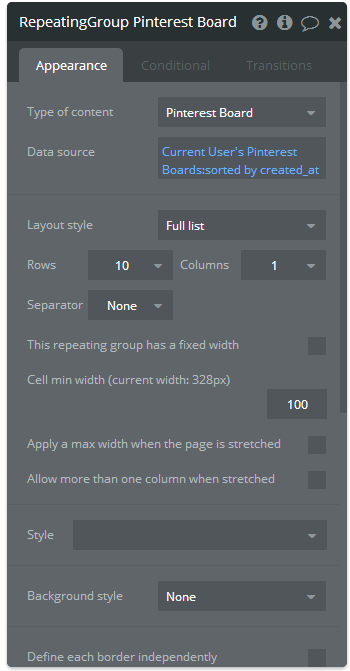

I have a repeating group within a group.
I want the repeating group sorted by the Pinterest Board’s creation date.

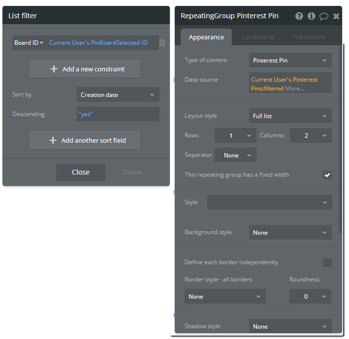

I have another repeating group in a group. This one is for the user’s pins. I want that filtered and sorted. The setup I have is the same as what I did for the board repeating group.
with the PinBoardSelected-ID being a field I created in the database to store that ID.
If I remove the sorting and filters, I get the list showing, but obviously not sorted nor filtered. With both commands, however, it isn’t working and I keep getting these errors:
Can someone help me with what’s wrong and help me get it right?!

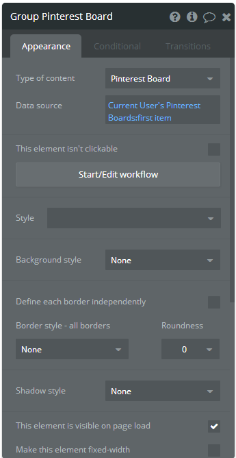

I noticed that the groups that contain the repeating groups had the wrong ‘type of content’.
I changed them both to ‘User’ and data source: ‘current user’, then each repeating group is
type ‘Pinterest Board’, data source: current user’s pinterest boards &
type ‘Pinterest Pin’, data source: current user’s pinterest pins
I thought that was what the problem was but I’m still getting the same errors
