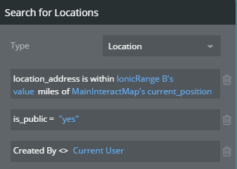

If you just store the text Zip code as an address you can do this, but as levon says it is going to be safer to use the search box and geographic address as I would imagine zipcodes/postcodes are not unique and you might get some odd locations.
From there you can use native bubble functionality on the search “within x miles” of the entered location. You don’t need an external API for this.

You shouldn’t need to import anything, Bubble links to Google to pull this back, and that should be up to date.
Bubble allows you to have search criteria based upon the distance between two locations. So all you really need to do is store those locations in your database, and you can search on them.
