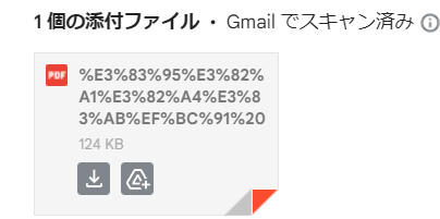

When sending an email with an attachment in Bubble, the file name gets garbled if it is in Japanese.

Here is the image of attached file which I received from bubble.

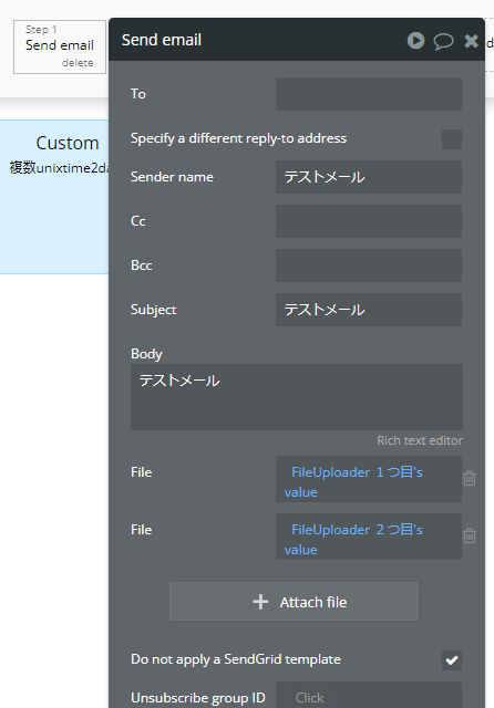

Here is an image of action in Bubble.

The issue is that I can’t find the place to set file name.
If I use the plugin “Sendgrid”, I can find the place to set file name.
However, in case I’m using default function of “Send email”, there is no place to set file name like below.
Just putting File.
Due to stability issue of the plugin “SendGrid”, I’m thinking to use Send email function.
Bubble doesn’t provide feature to set file name by using default function ‘send email’. basically file name derived from file url. So, if you want to set file name you have to use SendGrid plugin withou plugin right now not possible to set file name.
