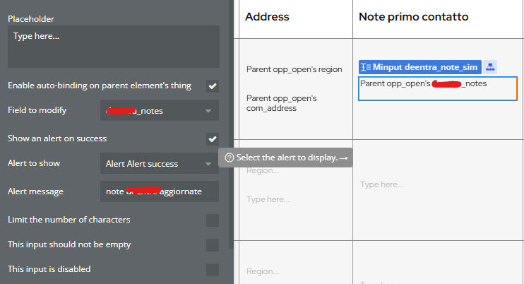

I have tried using autobinding, input change workflow and also by putting this condition:
but is not working either…
How can i resolve this problem?
Thanks in advance
autobinding is done on a parent element’s thing…make sure your autobinding is set correctly and that you do not have any conditions on the multline input element like you do in the screen shot as that on it’s own is likely the issue.
no but i added it to try to resolve it, the poblem was already there..
Are the privacy rules for autobinding correct?
I’m not so sure that is the case. Your issue is that you have the conditional. You use in the conditional ‘when the value is not the current rows value’ and then initial content is current rows value…This conditional is likely the cause of the problem.
Privacy Rules is not it because the autobinding is working, it is just autobinding onto the data entry a value that is not expected due to the condition on the multiline input.

yes, everything that is modifieble is enabled to be autobinded

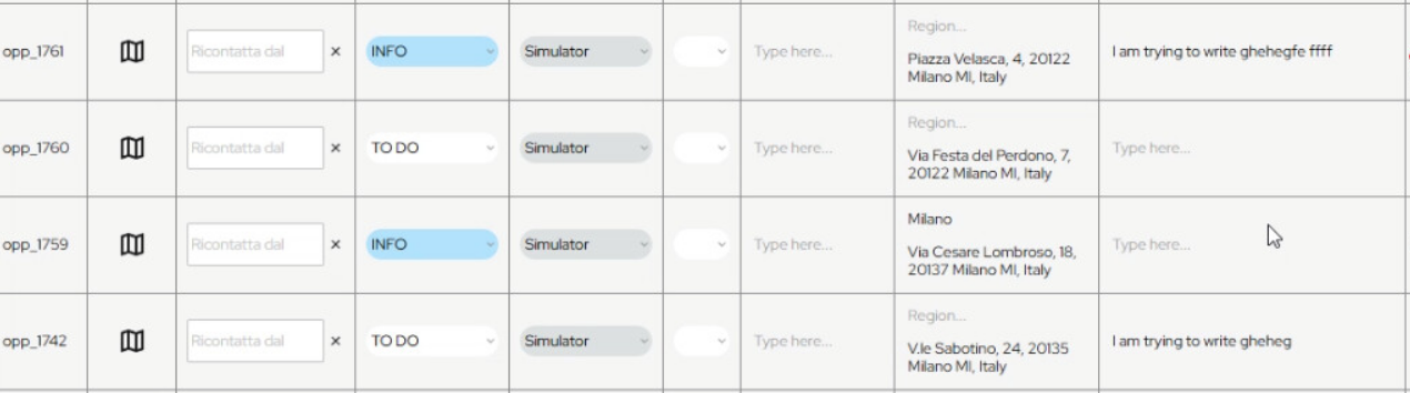

Anyway, I did the same trial without the condition to explain the problem to you more clearly:
  1. I am adding info in the current row (opp_1742)
  2. While I am writing, 2 different rows are gonna be added to the table (added rows: opp_1761 and opp_1759). As you can see in the image below the text is duplicated.
  3. Trying to refresh the page and see if its just visualization problem… Nop! the modification are duplicated in 2 different rows in opp_1761 and the original opp_1742:
This problem is coming in both of this settings (autobinding or multiline input is changed) and the problem is with or without the conditional that I cited before:
  1. Workflow input change
or
  1. Autobinding

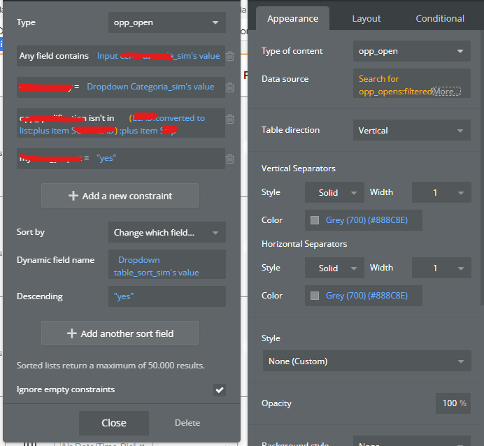

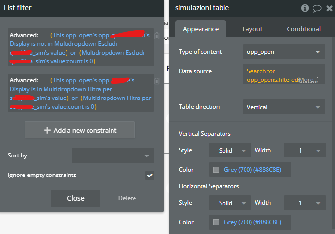

The table is made with this data source:
normal constrains:
filtered ones:
(sorry but I had to cover some text for privacy)

This is a known issue and I don’t see it being fixed soon. To work around, you might want to Display list in a repeating group rather than have a dynamic source so you can decide when you refresh the data.

Almost duplicated. What you have in 1742 is not the same as 1761 because 1761 has the complete last entered text, while 1742 is missing multiple characters.
But, I do see your point, that when a new row is added to the Table element through likely a database creation of a thing, the Table element and the Multiline Input Element are not keeping things tracked properly, likely an issue with the Table element handling of source values, and so when 1742 is being modified via the multiline input element, and 1761 is created, it is like they switch the Row and the multiline input is keeping up but the Table element itself is getting it’s source data crossed up.

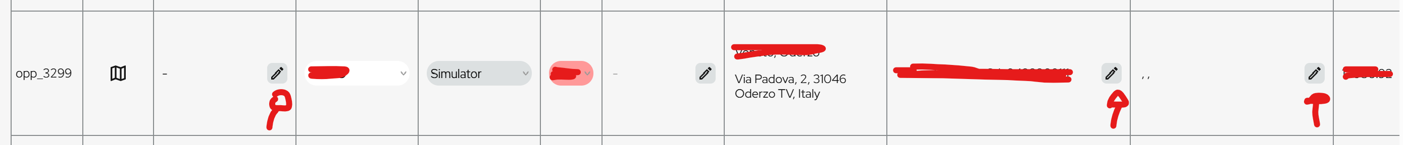

Thanks a lot for this amazing explanation. I’ve always used the table element because it feels much quicker to set up all the columns and data (at least to me, haha) compared to the RG.
I fixed the issue by placing all the edit buttons next to the editable data, like this:
I asked because I was curious if I was missing something related to the autobinding concept, but it seems that Bubble didn’t fix that issue because it’s not considered fundamental.
