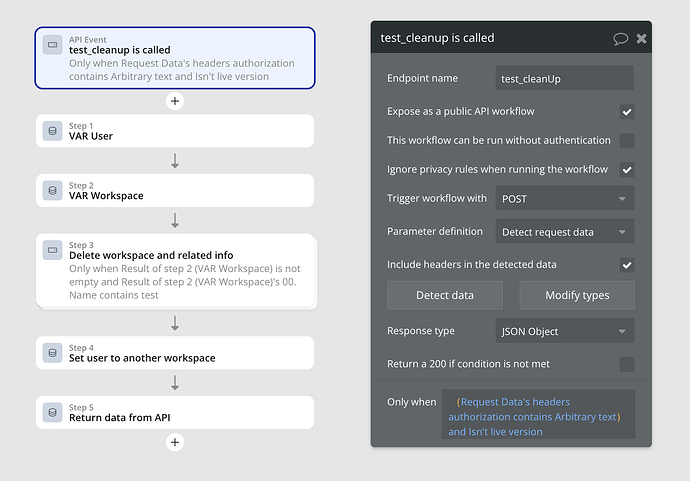

Set up / clean up
Setting up / tearing down
In one of my tests I test if I can create a Workspace in my app. I perform a bunch of tests and then I clean up that workspace via a backend workflow
Creating backend workflows
  • Generate a key on settings/API API Tokens
  • In backend workflows, create a folder “Testing endpoints”
  • create a new workflow
    • check “expose as…”
    • check “ignore privacy…”
    • make it a POST
    • parameters “detect request data”
    • check “include headers…”
    • initialize, grab that url
      • hit that endpoint
        • add header: Authorization: 'Bearer ${TOKEN_YOU_CREATED}
        • by sending the needed data in the body and
    • put a “only when” condition like “Request Data’s headers authorization contains TOKEN_YOU_CREATED”
  • perform the operations you need in that workflow
Example
Writing code for automated testing. Code to Bubble to Code to Bubble…
Man…I’d rather click buttons and fill inputs for hours on end…
