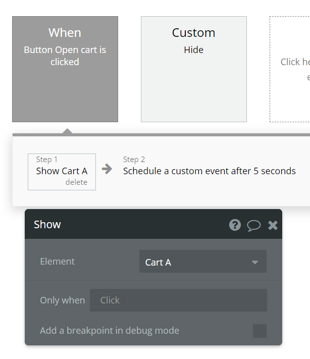

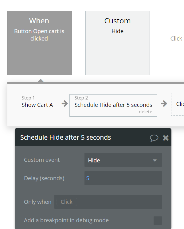

That’s not what @eren said to do. You hav eto create a custom event and then schedule that custom event
@paul29
I do not understand …
Step 1:
Step 2:
Step 3:
Step 4:
If that still doesn’t make sense then I would start learning some bubble fundamentals before moving on.
