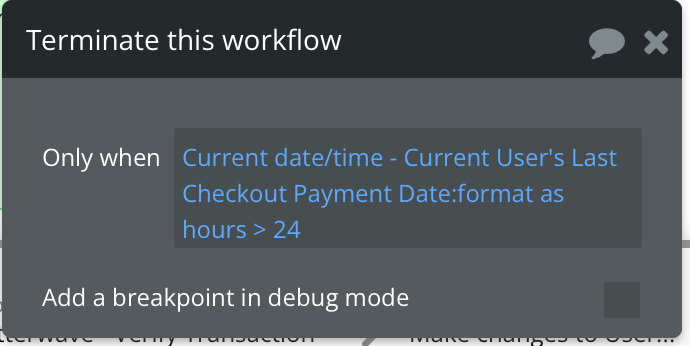

For this part, you’ll need to do Current Date Time – Create Date :format as hours > 20
Here’s a similar condition from my app…
Screen Shot 2022-12-02 at 5.16.25 PM

Hi @Buddha thanks you for your answer,
i am tried but i can’t figure out how you make formatted as “hours” when i chose creation data it only formatted as data
please take a look for screenshot
Best Regards

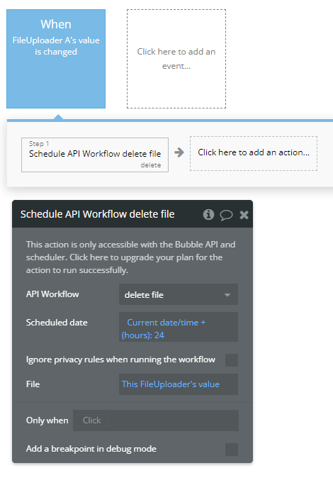

Create a backend workflow (with a parameter of type 'file), with a single action to delete an uploaded file:
Then, on your app page, whenever a file is uploaded (i.e. when the fileuploader input’s value is changed) just schedule that workflow to run in 24 hours time, and pass the uploaded file into it:

Awesome flow @adamhholmes , thanks you for your effort,
it will be a problem if there its 300-400 files a day? all scheduled to the backend after 24h?
it will store all this information on the backend when will be scheduled?
Best Regards
No it won’t be a problem at all… (unless you try to delete them all at the same time)
