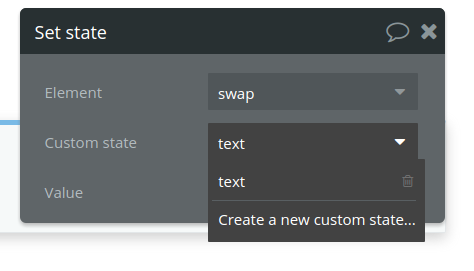

The action I chose on "When Button Is Clicked " was to “Set a State”.
I then created the state called Text of type “Text” right there. I attached it to the page (bit of an odd concept, but all variables/states need homes in Bubble). So that is why it is state Text (what I called it) of Swap (the name of the page).

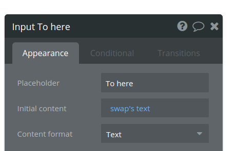

So I just set up the Input B field to take this variable/state as a default (Initial Content).

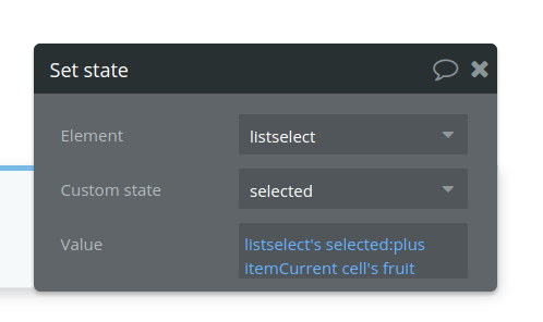

… I am using a state that is a list/array of things/objects to store a temporarily selected list. Each time the user checks a checkbox, that checkbox’s fruit object is added (:plus) to the list.

As I mentioned above, “Swap” is just the name of the page in Bubble. It is one of the elements you can add custom states to.
So I added a state called “Text” to the page called “Swap”. Hence “Swap’s Text”.
The input box is called “Input From Here” and I am using the value in that box, hence “Input From Here’s Value”.
