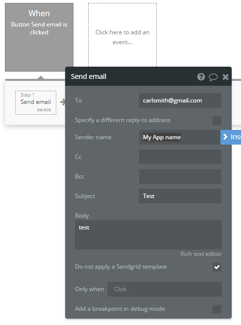

Have you tried to setup something simple like on click of a button > send email to ensure that you’re able to send before doing something more complex?
That’s probably the culprit!
