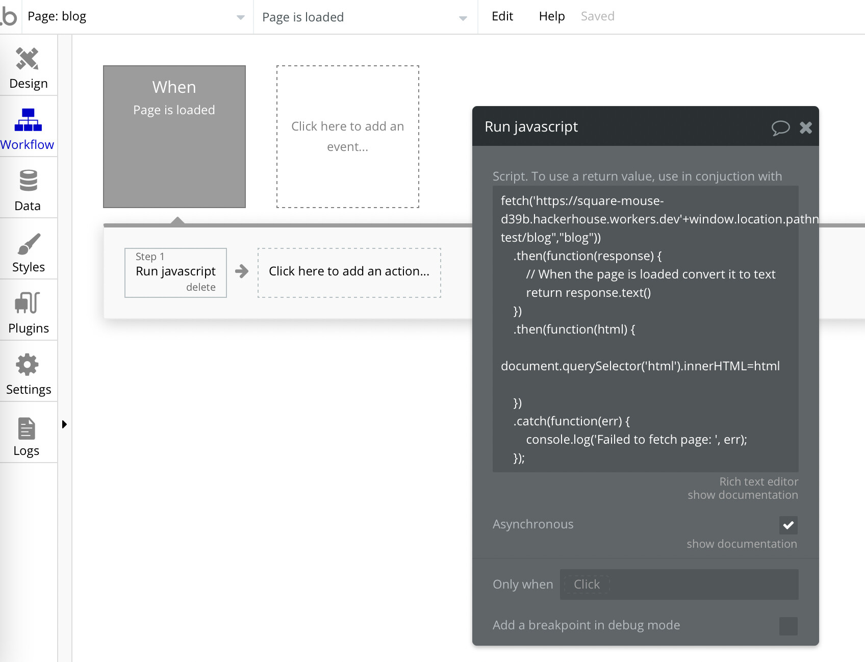

We are thinking about injecting the ghost blog inside a bubble page with javascript.
However we are not sure about the performance and responsive rendering.
We could release it as a plugin but it will take way more time…
For the moment we have our old blog built on bubble https://hackerhouse.world/blog/
At the moment I am going to keep mine at https://blog.userloop.io
I really hope there is a solution at some point for hosting it at /blog - there seem to be real benefits to doing it, and the main Bubble blog seems to have that ability!
@jamesdevonport @nickhutton13 we managed to inject through js.
We still go through the CF worker because the code was already working we just tweaked it.
It is experimental :innocent: :

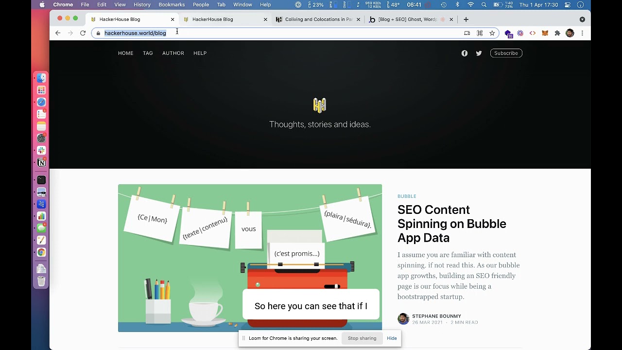

@jamesdevonport @nickhutton13 @johnny made a quick video :slight_smile:
Will update the blog post asap
This looks great, do you think there is anyway to prevent the flashing which occurs when you first load the /blog page? Thanks for the video, great demo!
yeah maybe fading or something before inserting the html. we will give a try :slight_smile:
Blog post updated https://hackerhouse.world/blog/ghost-cms-bubble-blog-subfolder-cloudflare-workers/#update-01-04-21
