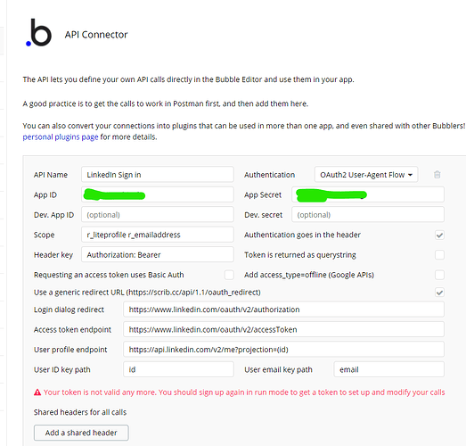

Users are reporting creating a new LinkedIn account returns an error. I go to my API settings and its telling me the tokens have expired even though my developer dashboard at LinkedIn shows I have not hit my 2 month mark yet.
I run the flow in a version-test, reauthorize the tokens, then a few days later, they expire again for no reason :man_shrugging:

about 3 minutes after I refresh the token by validating it on a version-test page, the error pops back up in the API connector

1 is if the user is already logged into their LinkedIn account when they sign up using LinkedIn on my website; and the 2nd scenario is when the user is not currently logged into LinkedIn when they sign up on my website using the LinkedIn. Both of these scenarios are occurring while an error exists in the Bubble API Connect Plugin “Your token is not valid any more. You should sign up again in run mode to get a token to set up and modify your calls”

Like I told, it’s not an error in API Connector. It’s just normal way Bubble work. API Connector doesn’t refresh token (for the backend user, you, when you try to create new calls). But it doesn’t affect your API Settings and it will continue to work.
If user get logged in, this is working. It,s normal that if the user already approve your app, they don’t need to approve it again. (they need to revoke auth before). There’s some API that will always ask and some that will let you have a choice to ask all, ask only new scope or nothing if they already authorize your app.
If your 2 scenarios work, you don’t have any issue.

In Version-test, authenticate to reactivate the token in API Connector and push update to live. Check if the error continue in live mode after.
Normally it should not affect your user that the API Connector token is expired. I suggest you to send a ticket support to Bubble if pushing live didn’t fix the issue. Recently Bubble made a couple of update on API Connector.
