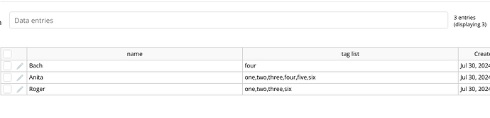

Data type has a field that is text, and you store the list of tags as a single text, separated by comma.

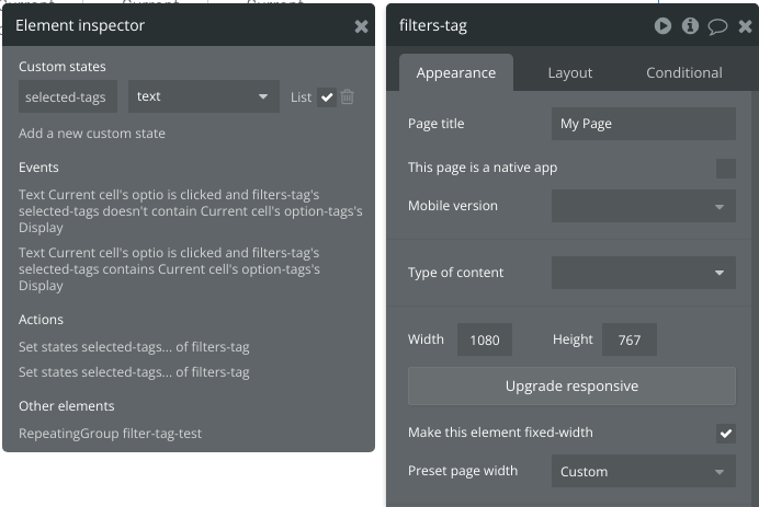

On page you have a custom state set to text and is a list
On RG, use the search with constraint contains keywords
I don’t have a bunch of test data to tell you that it is performant on 100k items, but it meets all other criteria I believe

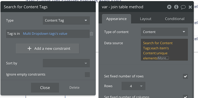

Here is another way to do ‘contains at least 1 tag’ without advanced filters:
CleanShot 2024-07-30 at 23.38.47@2x
CleanShot 2024-07-30 at 23.39.01@2x
For each Tag in Content’s List of Tags, have a separate thing Content Tag. Keep in sync using trigger to create/delete Content Tags as necessary.
  1. Get Content Tags where the Tag is in the list of selected tags
  2. Get each Content Tag’s Content (:unique elements could well be redundant here).
Nice due to its simplicity. I haven’t tested for WU - it may be the case that storing Content’s unique ID as a text on Content Tag and then Do a search for Content (unique ID is in xxxxx) is more WU efficient, but I’d go with what I did for maintainability.
The only additional WU costs are maintaining the join table of Content Tags, the costs of which will vary depending on your use case. They’ll likely be minimal compared to the WU saved and performance improvement you can gain by implementing something efficient.

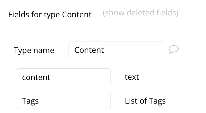

No, we have three data types:
  • Content (contains content and List of Tags)
  • Tag
  • Content Tag (contains Content and Tag)
For every Tag in Content’s List of Tags, there is a corresponding Content Tag thing. If I add a tag to Content, I must Create a new Content Tag with the corresponding Content and Tag. Similarly, if I remove a Tag from Content’s List of Tags, I need to delete the relevant Content Tag.
Content’s List of Tags is 100% fine as it’s highly unlikely there’d ever be more than a few dozen tags on a single Content :slight_smile:
