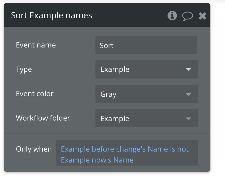

  2. Create a database trigger that reacts any time there is a change (ie: it’s new, or updated) to the field of the data type you want to sort on:

  • I use a Database Trigger to do this instead of of handling it in the “Create a new…” workflow because to me it’s safer to handle it in one place, over having to remember to implement this in every place where you may be adding or updating the data. Feel free to do it differently if you like to live dangerously.
