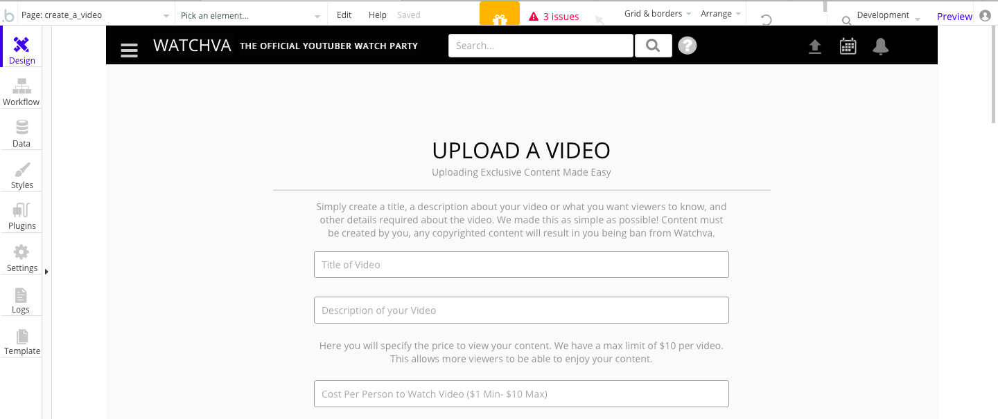

Thank you for the quick reply, im talking about as far as the platform ( we are working on something, thats the reason for the 4 errors. But thats not what im talking about.
For example: look at these two pages, and look at the header difference… We are using the same headers on all pages, but it seems as though its showing up different. But I can tell something is going on due to the actual bubble header itself is messing up. (look towards the right side of the screen, my icons to search (near “development”) is messing up).
Does HTML implementation mess up bubble? I don’t see how this would be the issue though.
@jamat1 - I only see one page.
Likely a “bleed” of styles into the editor. If you have a HTML element, the editor renders it to show something of what it looks like, and possibly some styles you have in there also apply to the editor itself.
I’m not having bubble issues but I did have, and a few others on the forum, had problems with HTML Page headers after the new branding. Instead of putting the HTML in the page header we moved it to when the page is loaded and everything seemed to be ok. Not sure if that is your problem but it might be worth a shot.

Simple question: when you refresh the editor, does the issue with misalignment of items in the editor persist? (Follow-up: when you click the “gift” icon - does the issue persist? Maybe it is inadvertently stretching the page).
For consideration, when I disconnect from my external monitor, sometimes I encounter quirks in how the page re-cobbles itself together to fit a new screen size, causing some occasional rendering issues. As well, intentionally using the zoom in/out from 100% causes issues like your screenshot.
Its was the html implementation, it was messing up editor as well. We fixed the issue. Thank you guys for your help!
