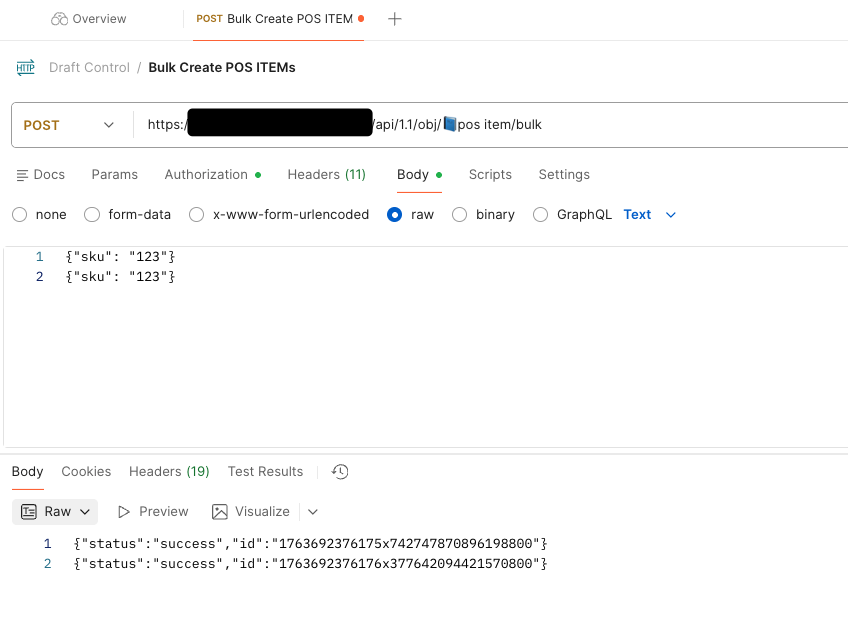

Anyone knows why I am getting this error with bulk create? There is no problem with single create. Some had this problem before and Bubble supposedly has fixed it.
Added: here is the bulk data API spec.
I have the exact setup in Postman and it works.

So do you see anything wrong with the bulk create screenshot that I have posted in the original post?

Using the bulk API is a text request with each line a JSON body for each object to create
This is not an array of json like you say and the content-type is alsno not application but text/plain
The issue I see if I compare to your postman request is the key you are using. In Bubble you have set “sku id” in one of you screenshot while this is sku in postman. So be sure to use sku
As for data type, this must be set to TEXT because this is not a JSON that is return but a text with a JSON on each line
One of your screenshot also show a POST create a thing (not in bulk) and this returned a JSON (so you should set this a JSON not text. First screenshot)
I have both sku and sku id as fields. In the OP, it shows that the sku works for single create but not for bulk create.
You can see that I have the exact setup, following the API spect in Postman and Bubble.
I think it is a client side bug to this Bubble app. The same setup works from another Bubble app calling this app’s bulk API.:sweat_smile: I have submitted a bug report.
Note: This is from another Bubble app calling the app’s bullk data API in the OP app.

Is the issue not just that you have a space in your actual URL? You seem to be trying to do a post request to /pos item/bulk which will fail. You can’t have spaces in api workflow names you want to call like this. It’s treated as a URL so name it as such.
As you can see from this screenshot, Bubble and Postman both can handle emoticon and space in the API URL (for bulk). It will just do url encoding. And the field name exists.
I can’t compare the header as the API connector entry can’t be initialized. So the API request has not left Bubble app yet.
I have manually created a new bulk API from scratch. I have tried a different data type with space and emoticon. I get the same error.
As you can see from the screenshot for postmand and another Bubble app, the same setup and payload work for both of them.
