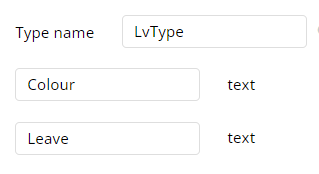

A data type was created for the Type of Event/Leave as shown below.

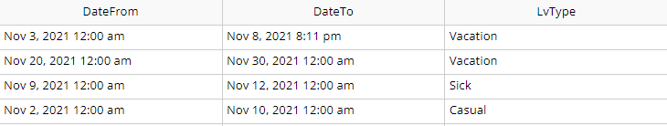

The app allows users to create applications and choose the type of leave that is the event, ie. Vacation, Sick or Casual.
I want the app to dynamically show each Leave Type by its respective hex color.

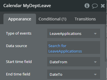

I knew I left out a screenshot. Yes it is related in a Data Type called Leave Applications.
The datasource of the calendar is therefore LeaveApplications.

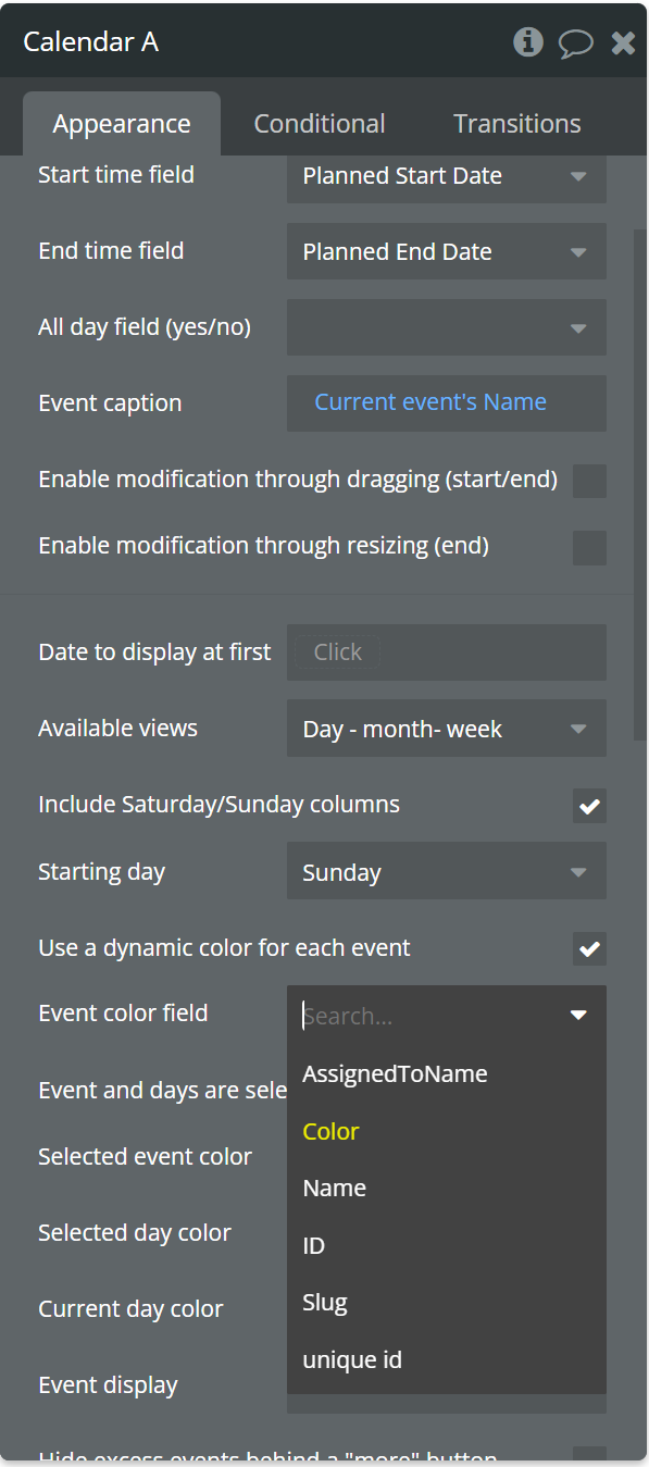

You would expect that something like Calender A’s current events’s LVType’s Color would work. But when you select the option “use a dynamic color for each event”, the field changes to a dropdown and it is not possible to insert dynamic data anymore (see screenshot*).
It seems that the easiest option is to create a field color in your datatype “LeaveApplications” and fill it automatically based on the field color of LvType when a new leave application is created. I tested this and it works (although it is not a beautiful solution).

*Not possible to use dynamic data:
