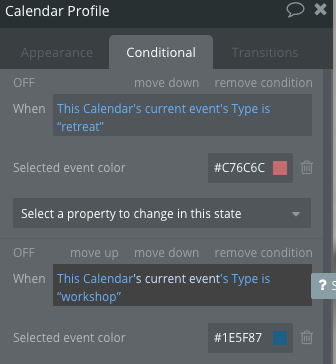

I am trying to have the Eventcolour change according to another Field (of Type in my Database).
Is there by now a way to do that?
so does this work:
(tag is a field, eventcolour is a field)
WHEN tag=retreat -> Eventcolour=#F33333
I read it wasn´t previously possible, but is it now? @emmanuel @romanmg @mishav
or is this maybe possible in conditional? (if so, how? I haven´t been able to to do it)

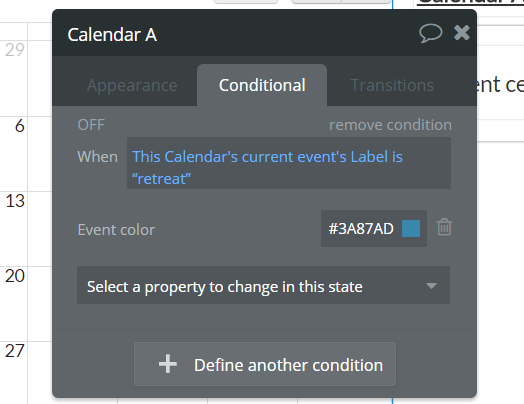

Yes, a few different ways to do this. Easiest is the following condition, which is exactly what you describe: when tag = retreat > event color = hex code
That just changes the default event color to whatever you want. But, you can also make the event color field dynamic so that it always points to a field with a hex code. Check “use dynamic color for each event” and then you select the field (in your case, “Eventcolour”. On top of that, you can use a condition to change the field (when dynamic color is checked), so that if you have 2 different fields with different colors, you can change them.
EDIT: I think option 2 is actually the one that will work for you now that I’m re-reading your question. So, turn on dynamic color so that it will pull from whatever is in the field for any event. Retreat, for example, would have a different value than some other tag.
Hey,
Thank you so much.
I do however still have one difficulty:
I can only select `selected event colour´ to change , which means the colour only changes once I have clicked on the event.
Am I doing something wrong? ( use dynamic is enabled, and even colour field is colour:))
