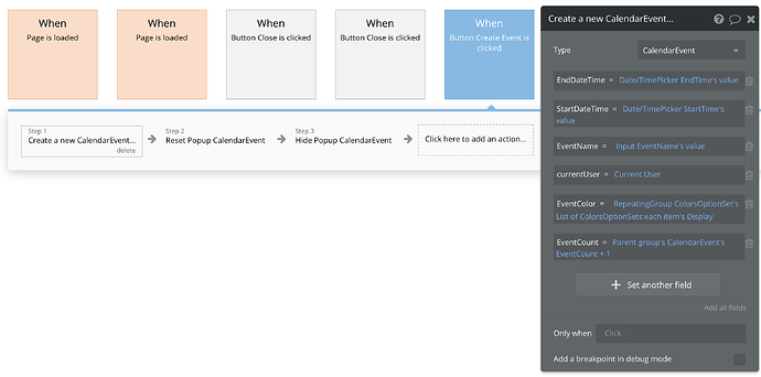

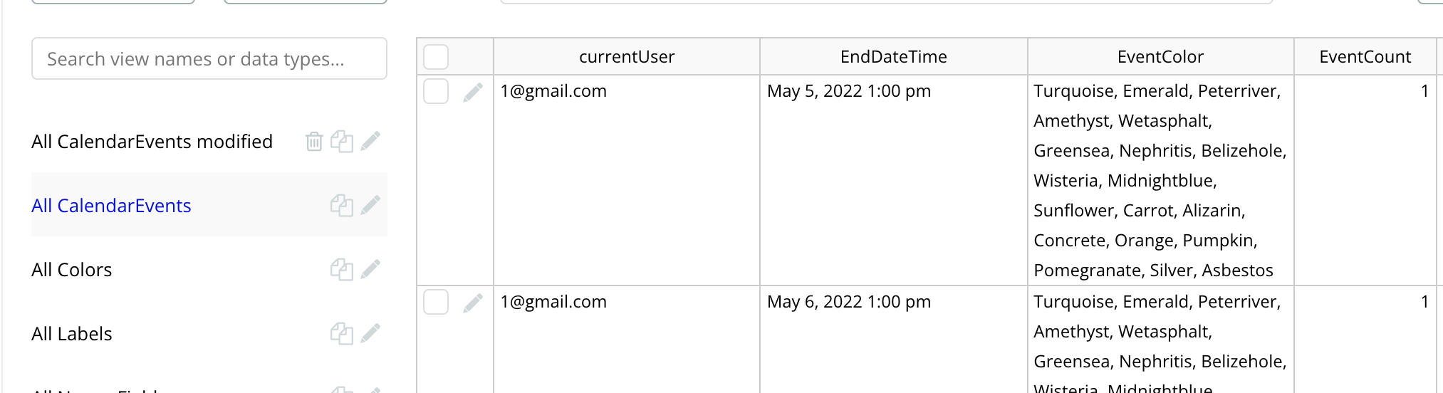

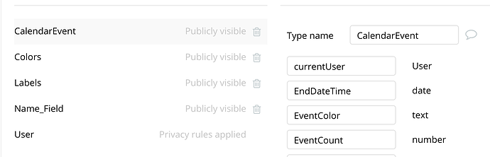

My setup looks like this:
Database
Workflow when creating an event

This is where Im trying to get the count for the number of events right now I get the total number of events but need the total number for that particular day.
The preview it displays 9 instead of 4

Hmm, I’m not sure what you are trying to do, and I don’t understand the purpose of the EventCount field. Are you clicking on a specific event on a specific day, and in the resulting popup, you want to see a count of all of the events that are scheduled for that day?
Hi Mike,
For right now Im just trying to get the total number of events in whatever day is selected (maybe Im doing this in the wrong spot I just chose that popup to test with) on Sunday May 1st 2022 there are 2 events so I was using EventCount to try and get that number.
Ideally later I’ll use it to limit the number of events visible.
I added another element under the one you had, and it appears to be showing the right number. You might need to play around with it because I don’t understand all of the details of the events, but it looks like a step in the right direction.
