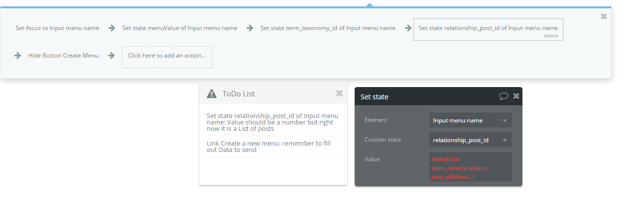

I’m trying to have a repeatable group show all related items after a person selects a value in a drop down. The issue is that I have to traverse a few tables to get the correct relationship between the drop down value and the list items. I’ve gathered most of the data required, but now I’ve made it to a data type that is really a list and not sure if I can store a list in the Value field on a custom state.
Here’s an example of the list where the term_taxonomy_id 13 has many object_ids
Here’s my workflow so far.
Yes, you can, but our list operations there are a bit limited. So you can put a list in the state, but adding removing items isn’t currently possible.

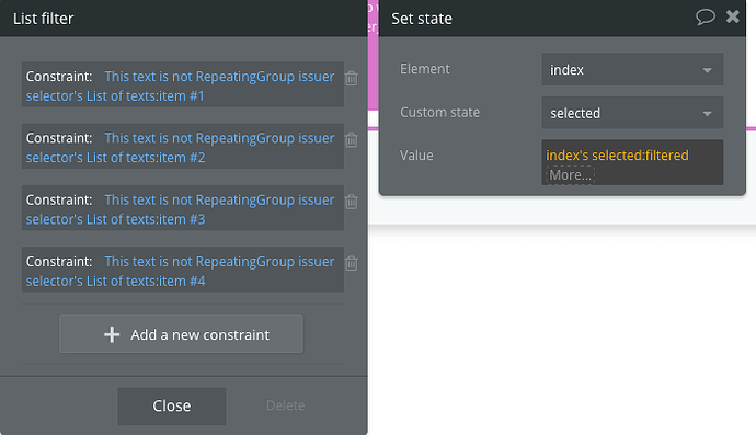

Is it possible to remove a list of items from a state using filter?
I tried to remove a list of texts from the state, but I get an error. Instead I have to remove each individual item.
Are you trying to clear the list?
I don’t want to completely clear the list. I just want to remove a group of items from it and keep everything else in it.

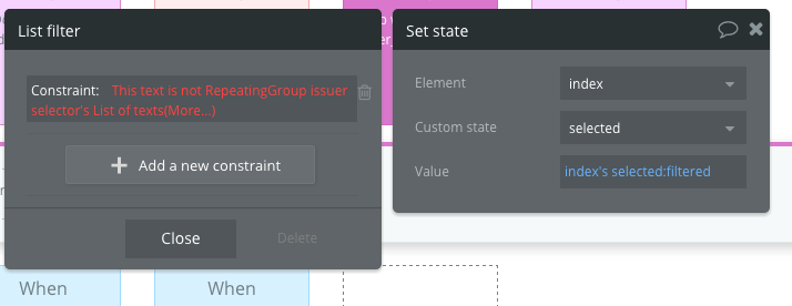

The state holds a list of texts. I want to remove all texts from the list that are in a repeating group. In my second screenshot, I can remove each text individually with item#. But it would be easier to simply remove all of them.
I can’t seem to remove a smaller list from a big list. I can only remove one item from a list.

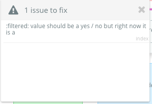

Try swapping the terms around on the constraint, [list] doesn’t contain [item being constrained]:
