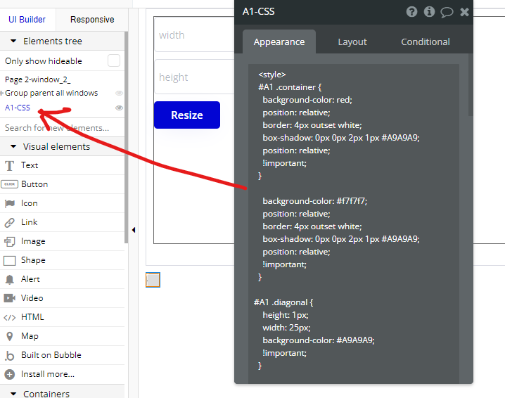

Current all the CSS is in the window’s HTML element, do know know if it is possible to move the CSS to another HTML element? I have tried this below but it’s not working …
I simplified the window HTML element and added an ID Attribute “A1”.
Then I added the CSS to the other HTML element. The result is no image displays.
now I can’t see this code in your app
please make two different HTML and paste this code again and let me know I will check and help to you
@bubbledeveloper1 Thank you so much, I have been going round in endless circles with this. Apologies for removing the code, please see the index page which has a tidy project for you to work with, it has the code for the window which you can copy/paste.
Hi, I think I have figured out how to link the HTML to a ‘style HTML’ element (2 elements). Weirdly I am not using an ID Attribute, but it works. I will update this thread when 100% complete with a solution.
