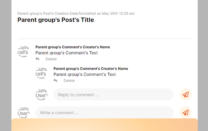

but i have another issue i would like you to help me with… i have successfully created the other one but now i need to be able to display multiple comment from the database but i have been able to replay existing comment and not create a new one under a post please how can i store multiple comment and retrieve them accordingly
If you are looking to create comments on a post, It’s certainly possible. This is something I have done in my own app.

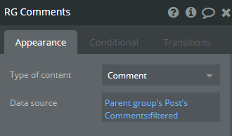

I’m not sure what your app looks like, but basically when you create a new comment you attach it to the post’s list of comments.
Then you put the data source as that list of comments.
When send is clicked:
ohhh wow i get let me try it out i will get back to you
so i will create another repeating group inside the first repeating group and create another field that is list of comment ?
That’s only if you want replies to comments like me. I suggest you try to make comments only first. To make sure you master that first.
