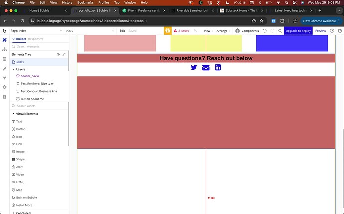

Bubble Editor:
Action done when clicked on an email Icon Example
Reminder, I do not want visitors to have to sign up for this to work. If a potential employer wants to send me an email they can reach out to me that way.

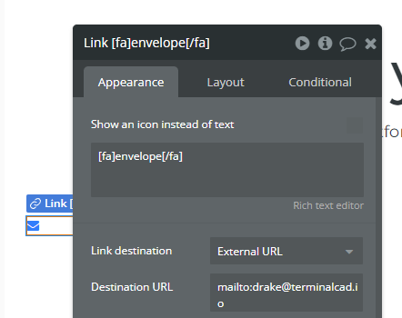

You could also just as easily use a “link” element type, change it to external, and just use this web URL:
mailto:[EMAIL HERE]
In the element, you can use an envelope with Font Awesome:

  2. Much simpler but easier for spammers to harvest your email address: Add a link element, and set its URL to mailto:someone@example.com . Having the ‘mailto’ prefix will cause the user’s default email program to launch when they click it.
Thank you for this response. Is there a way to use the visitor’s own mail application system to send an email to me personally?
Option #2 above!

Image here:
Be sure you’re adjusting the size of the icon element (i.e., not the size of the group element that contains it).
