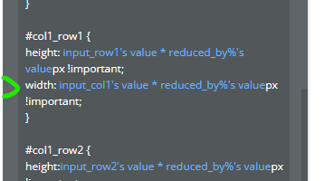

All that happens is the input field turns red, but the cell still minimizes and doesn’t retain it’s width. The issue may be because the size is being controlled by HTML and not from the standard Bubble inspector settings.
I need to somehow add a condition to the HTML which says 'Only when input_col1’s value is >99

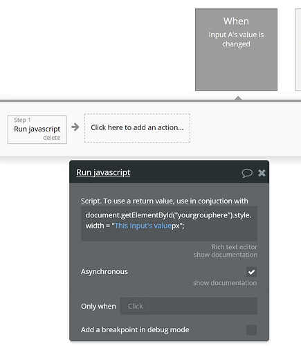

I’m wondering if this would work/helps you using the Toolbox plugin:
I believe as long as your input has the minimum set it won’t actually trigger this until it’s above the minimum value

You can just use a Boolean expression in the CSS, then format the output of that (the yes/no) as a text…
i.e.
input's value: < 100: formatted as text
Yes = 100
No = Input’s Value

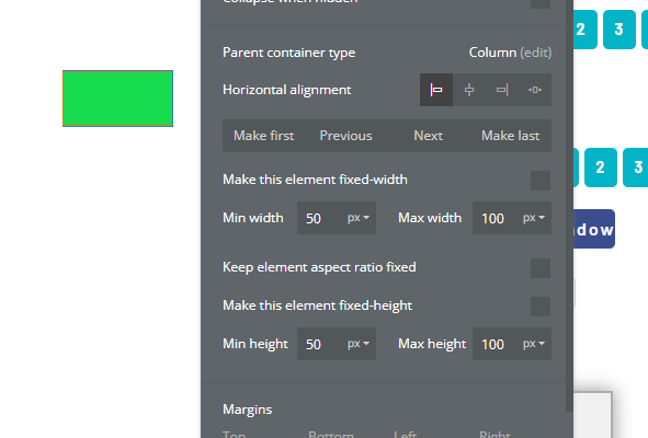

Because of this limitation I use the internal window input sizes to ‘stretch’ the container height, when the frame height’s input is ‘1’ then it shrinks to fit the content. However, when the frame width input is ‘1’ then it does not shrink, instead it goes to 100% wide.
Another observation is that ‘shapes’ default to max width and min height settings, when really it should be a square.
min max

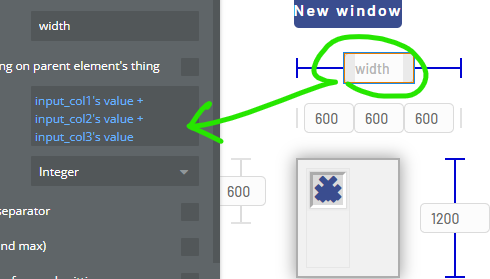

@adamhholmes I have a solution which is fine for my needs. I have disabled the width input and instead I show the width based on the column widths;
input
This preserves the overall width of the css resizer shape because the shape expands based on the widths now.

Shapes behave differently from groups (something to do with the flex-grow property I think…_if you change that to 0 it works the same as a Group)… so you can try using a Group instead of a shape…
Or, you can change the flex-grow property of the Shape to 0 flex-grow: 0 !important; (that works as well) - I’ve done this on the demo app you linked to above and it’s working perfectly…
Also, in your example app there, you had the parent group (Group A) set with a minimum height of 1000px - which is why the height wasn’t changing using ‘height’ in the CSS…
So if you take out that minimum height setting it works just fine… so that’s another option…
Or don’t use ‘width’ and ‘height’ in your CSS… use ‘max-width’ and ‘max-height’ (just leave the max width and height in Bubble set to infinite)… that also works as expected…
So, a few options to play with, but if you’ve already found another way that works then great…
