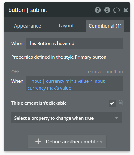

I have two inputs formatted as CURRENCY. These require the user to input a minimum value in one and a maximum value in the other. Is there a way to make sure the value in the minimum input field is not equal to or greater that the value in the maximum input? I am not presented with the option to use a dynamic value here.
Hi there, @ericwillcampbell3… yes, it is possible to do what you described, but the question is what do you want happen when the min input’s value is greater than or equal to the max input’s value? For example, here is a condition that disables a submit button in this situation.
You could do any one of a number of things when that condition is true, so again, what do you want to happen?
