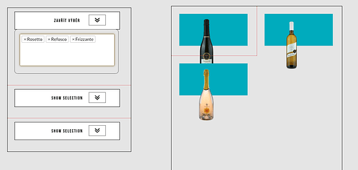

Hi, I have this workflow that load images from multi-select dropdown. And and it changes amount of shown values base on selected ones in multi-select.
But … when I deselect values in multiselect they stay hidden. Which I don’t want.
I assume that there is same principle as with state is yes/ is no. So can someone help to ‘‘reverse’’ it?
Workflow:
This is before and after making selection in multiselect:
Before:
After:
Thank you

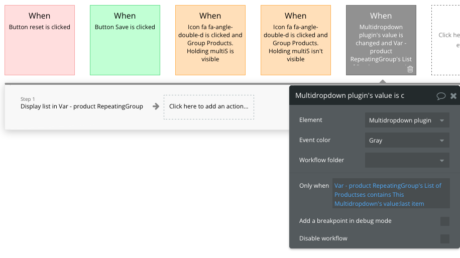

If my assumptions are correct, I’d get rid of the “when input changes” workflow and instead change the repeating group data source to:
  • Search for things ([whatever field] is in multidropdown’s value)
    – make sure to check the box that says ignore empty constraints
I could be way off, though. Tough to tell exactly what you’re going for without seeing the repeating group data source, workflow trigger’s data source, & the multidropdown’s list of options.

Got it, so my assumption for #2 was wrong. Based on your setup in the editor, I think the best way to go about it would be to change the data source for var - products repeatinggroup to:
Search for products: minus list: multidropdown plugin
There are more efficient ways to get this done, but that should produce what you’re looking for.
I like it. But i can’t choose that multidropdown at the end. its not on the list.
Got it. How about:
Change var - products repeatinggroup’s data source to “multidropdown plugin’s value”
Then change the main repeating group (the one with the images) to:
Search for products: minus list: var - products repeatinggroup

Try setting var - products repeatinggroup to multidropdown’s value via the “when input changes” event.
Then set the main repeatinggroup to “search for products: minus list: var - products repeatinggroup”
