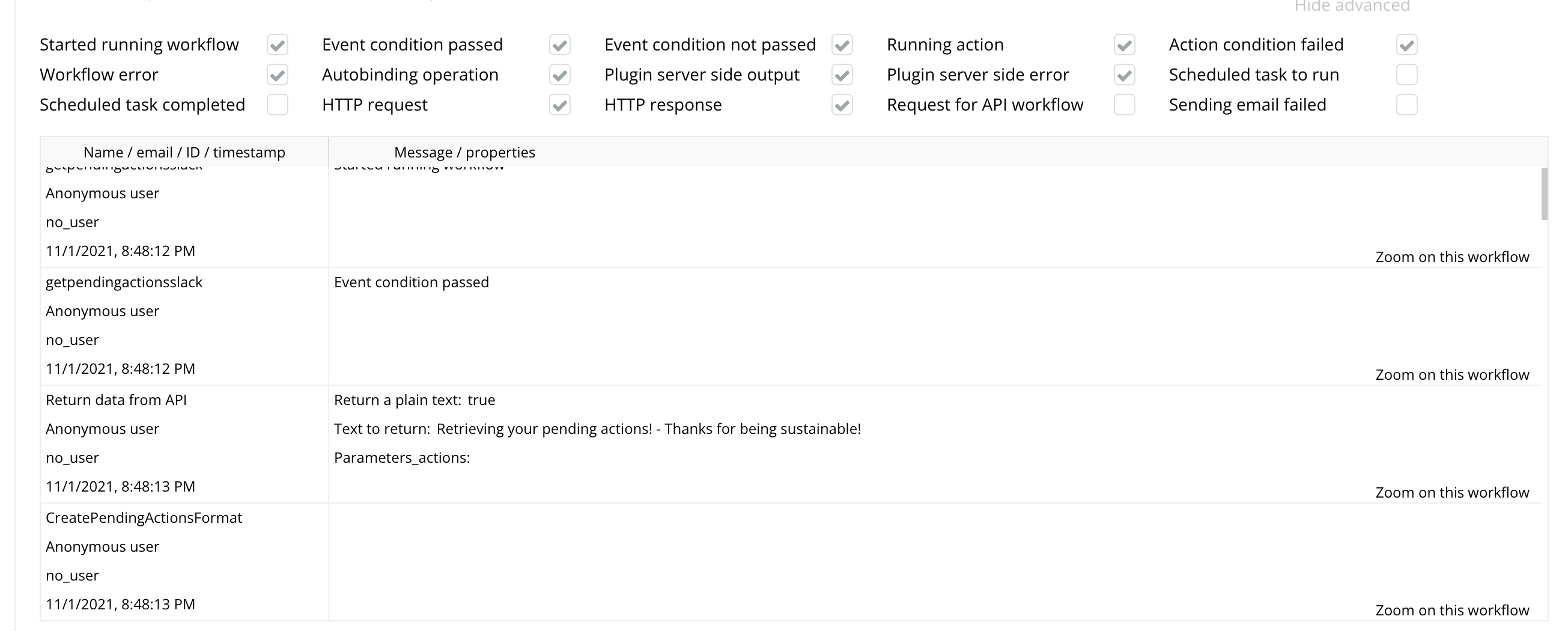

Has anyone been able to see server logs? console.log(“PRINT”) does not show up in my logs of a server side plugin I am building.

Hey Vinny- I did try that exact code but my server log is entirely empty. Do I need to do something to enable logs to show?
@spencer3
Let’s troubleshoot:
1 - Write “ten minutes ago” at the first field and “now” at the second;
2 - Make sure the other fields, “user email” and “contains” are empty;
3 - Check all boxes in the advanced field;
4 - Press “Search” button again 30 seconds after you run the server side workflow action;
5 - Make sure the test version of the plugin is installed in the app, it will be in the editor URL, something like &test_plugin=1543086664409x454646894723334140_current only that the ID will be different.
Let me know if these helped :yum:
Also, what plan is your app on? You can message me that privately if you want.
