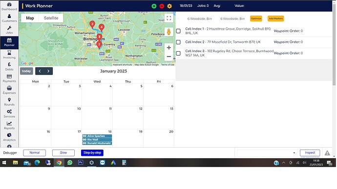

The main issue i’m having is that it will only give me the value of waypoint order is 0.
It just wont seem to optimize or output an actual order for some reason

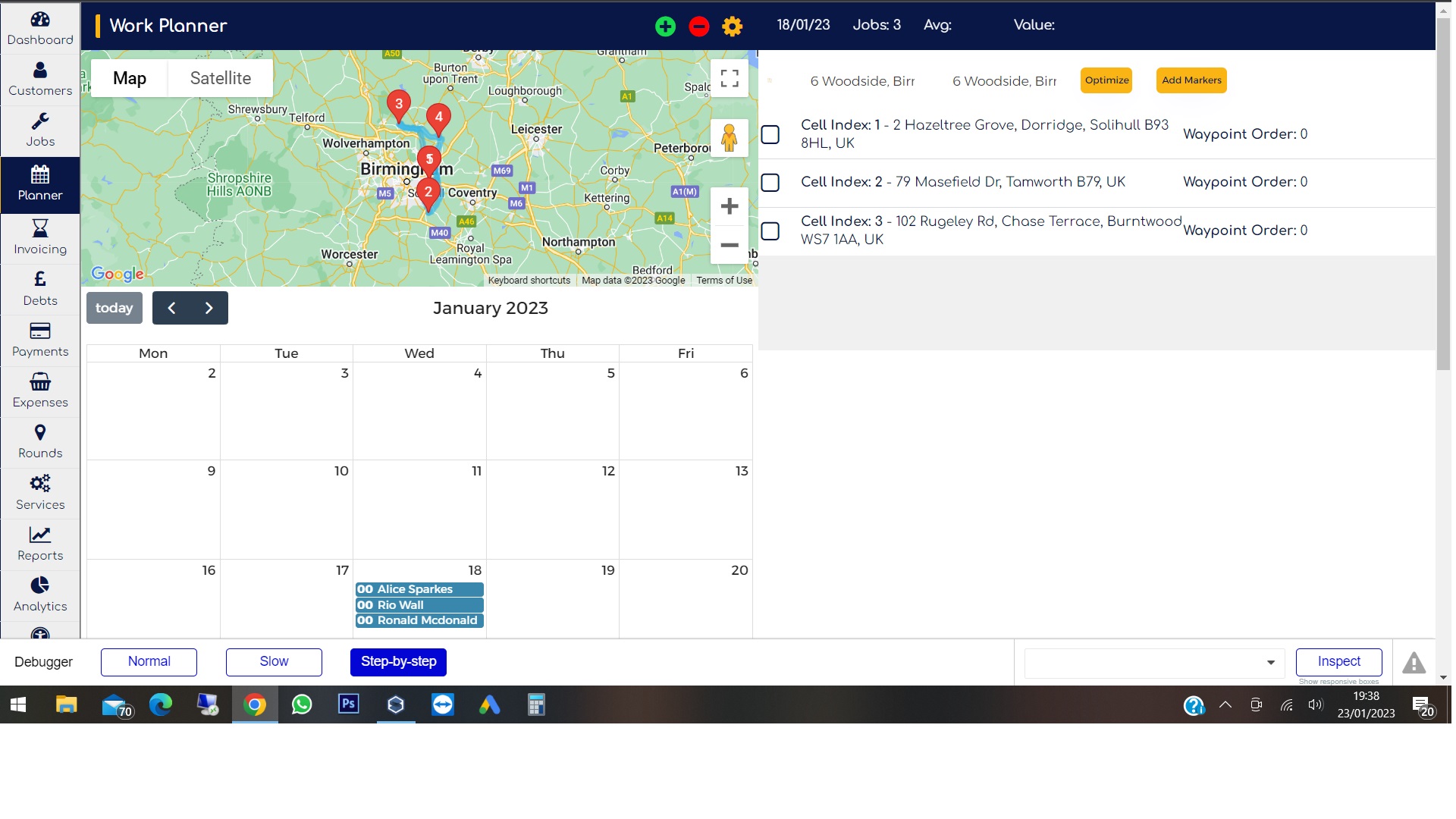

On the API connector I have a single address listed, however the actual addresses im trying to calculate are from a repeating group, the one in the work planner screenshot

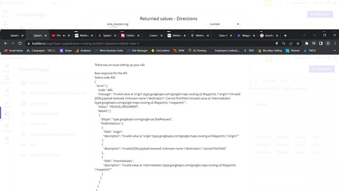

For starters it needs to be a POST request and it looks like you might be using the directions endpoint but you’d need to use the routes endpoint
https://routes.googleapis.com/directions/v2:computeRoutes

Yes I have just set up the Routes API ( I didn’t have this one) and just trying to understand/work out the documentation now
This API is something I can’t understand. It’s like the language it uses is different. I can’t even get it to connect
Do you have any idea which part im getting wrong?
Yea, you’ll need to manually write out your request in your JSON body below instead of specifying parameters. For any dynamic values you’ll use <some_var_name>

But yea what @doug.burden said, it’s wants a JSON body (like every API does)
Right now you’re putting everything in the Parameters section instead of typing out the JSON body
