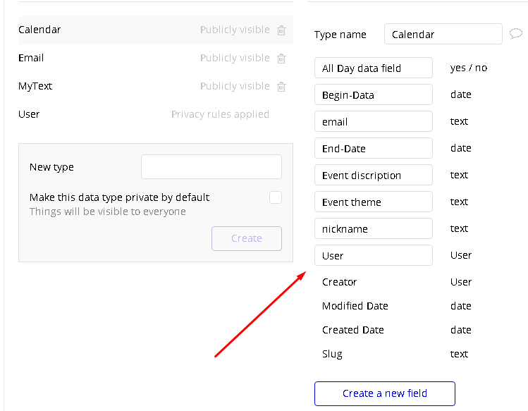

You should have a user field in your calendar database in order to be able to identify the events of each user. This make sense? As I saw, you don’t have a field where the type is “User”. So create a field called “User” (Type = User) in your calendar database.

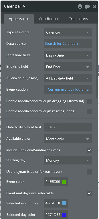

Now you have to change your calendar “Data Source” to Search only for Calendars where User = Index's Selected User
Yes!
This sloud work

I think you are not saving the new event in the name of the selectec user.
Remember that the selected user is beeing saved in the Selected User custom state, in your index page.
You should use User = Index's Selected User
You are using User = Parentgroup's My calendar's User
Could you check?
Wow, that was true )
Ok, so now I can go forward
Thanks you, Rafael!
