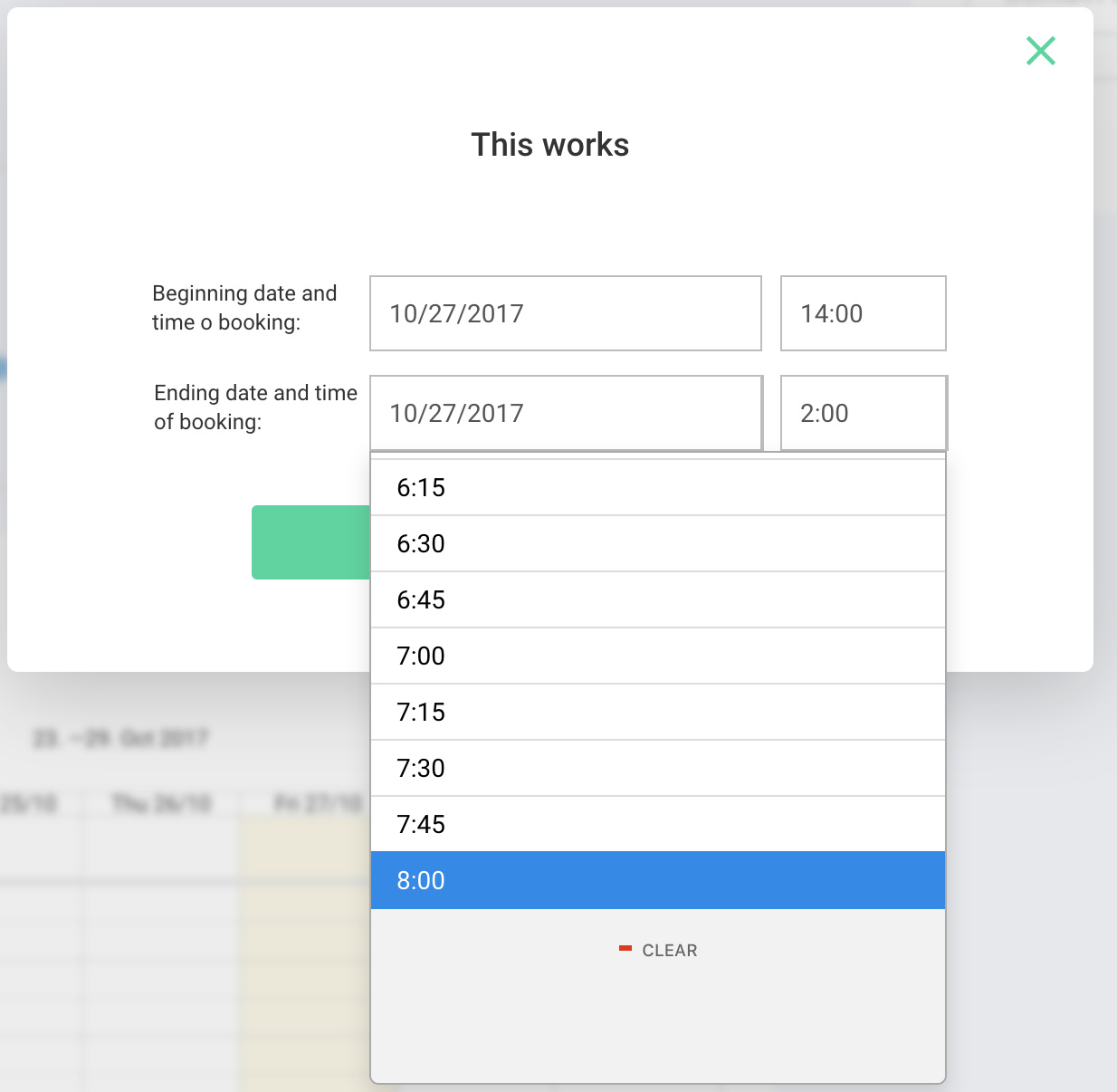

So I did this
When I click on date A , I still have the previous day available which is not okay.
When I click on hour B it will show a range from hour A + 3 hours (as it is set for that listing). But if I change the minimum hour from A to something else, on B will not be updated. E.g. A: 12:00, on B: 15:00 maximum hour at a 15 minute time interval. But if I change A: 15:00 B will still have the range from 12:00 to 15:00 instead of 15:00 to 18:00.
Should I make a workflow to reset input on B when A’s value is changed?
Okay so I realized that I should have used DateInput A’s value instead of Date/TimePickeg A’s value.
Now I am facing some issues on the way that the hours respond:
  1. If the first hour(A) is not selected by user, the second (B) will have some strange default value set as A value’s would be 6am.
  2. If the A value is selected between sharp hours, e.g. 15 minutes, 30 minutes, 45 minutes, B value’s will not add those minutes. I thought that if I add 2 hours to A value, and A value’s is 14:15, then B value’s will be 16:15 not 16. Should I also add a condition for minutes?
