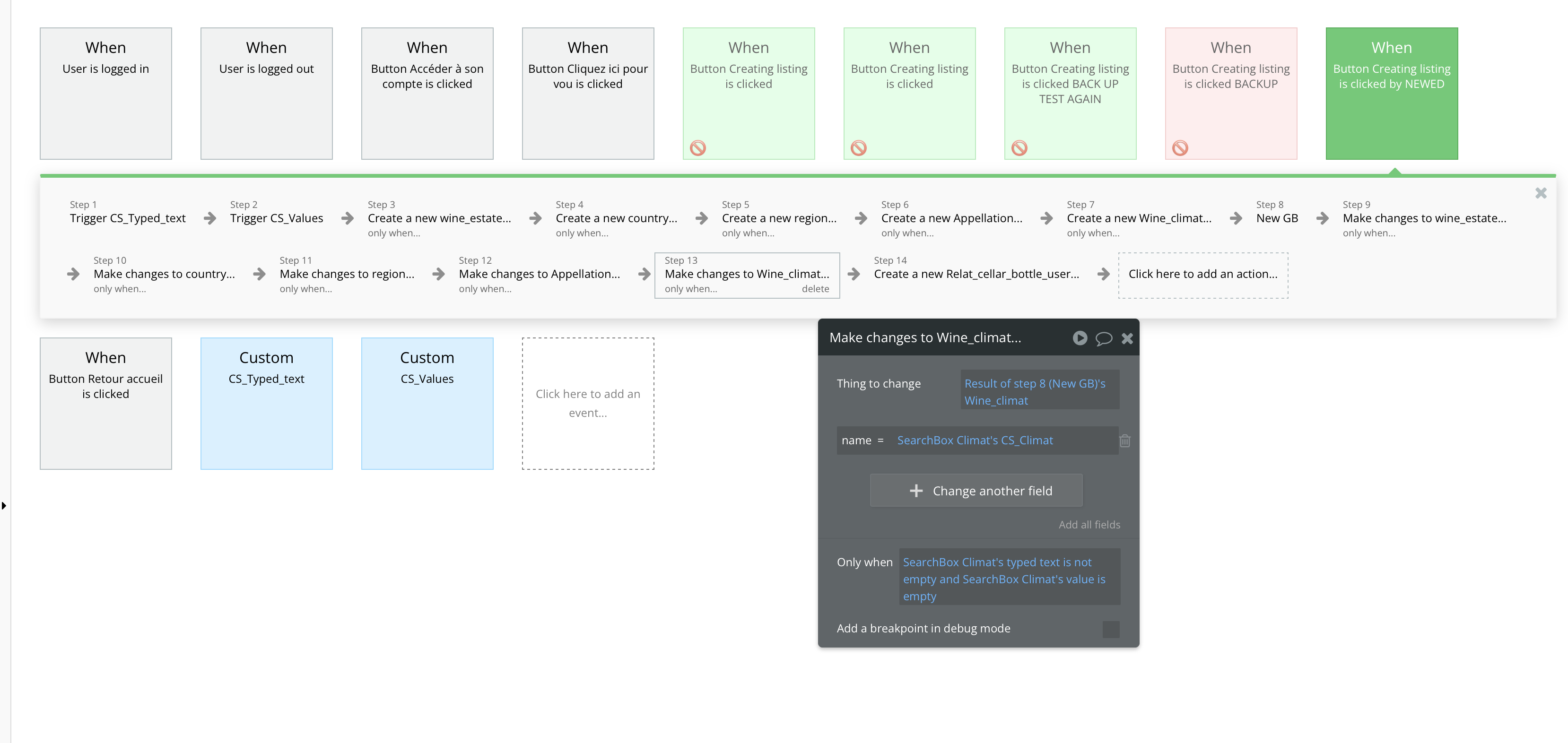

Thanks a lot for your help Newed. Now I use 2 different workflows and it works (partly) : I can use the typed text format in the other workflow. This last WF is a custom event because I want to respect my sequence.
Here is the link of the view mode of our app
Here is the main WF
And the custom event one
So basically I want to create a bottle of wine with different characteristics that are stored as other data tables.
So in the first 5 steps, I store those characteristics ONLY if they are unique, then I create the bottle in step 6 but with the searchbox’s values (sometimes empty).
Then if those characteristics were unique I make change to the bottle’s ones with the 5 first results (steps 7-11).
Then I want to use the typed text and apply it for this LAST bottle created thanks to the custom event which allows me to use the search box’s typed text. So I make change to those bottle’s things (last item created).
When I do that and look at the step by step debugger, it is supposed to work but when I look at the bottle in my database (which the custom event effectively called and modified) those modifications are not done and those values stay empty.
Here is a view of the debugger which shows that the last bottle created sees its specific value modified
I really don’t get it…
Could you please have a look. Sorry to take your time…

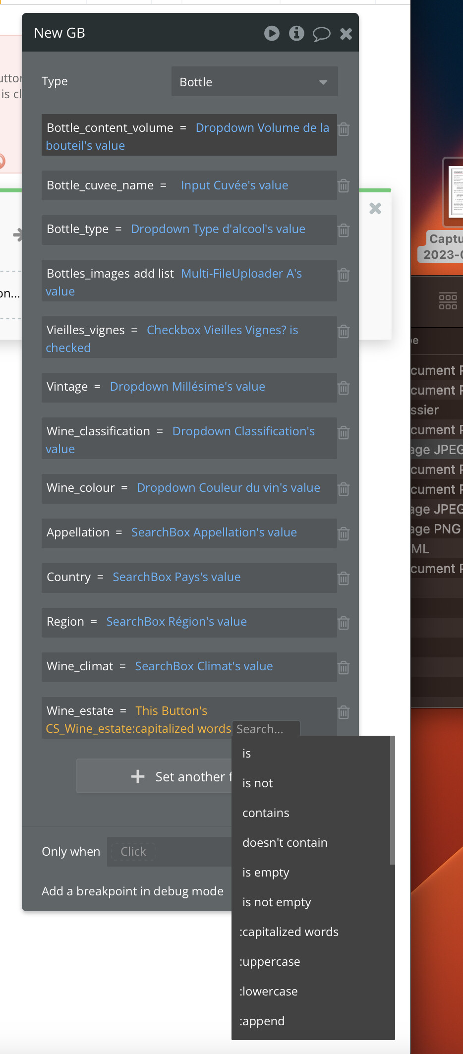

You could store the data for each input in a custom state. I know this would increase the amount of WF, but it would be more WFs with less actions in each one. This way, when an input was changed, its value would be stored in that state. Here you would need to work with the two possibilities, "value is not empty" and "typed text is not empty" or any other condition using these two input states that results in the same approach. This way, the final stored value would be a text for both cases.
Now you would have a single reference to the values when creating the “Bottle”, which could be the first step of the WF. And the other steps would just be to update the other tables with new values if they don’t already exist in them, and for that you could refer to the results of step 1 (where you saved the “Bottle”) and insert some conditional like "Do a search for "table":count < 1" to check if it doesn’t already exist in the table, in which case WU would be consumed. Another way would be to check the content of the input itself, after all, if "value is not empty" means that the value already exists in the table and therefore, there’s no reason to create a new thing in that table, otherwise the value doesn’t exist in the table yet (I hope you understand). Theoretically, this last verification approach would not consume WU.
There are some problems that could arise over time in these “auxiliary” tables since they can receive any value entered by the user, which could be duplicate values, but with a change in some character, way of writing (uppercase, lowercase and capitalized ), unnecessary spacing at the beginning or end. To work around some of these problems, when storing data in custom states, you can format and modify them using operators (they can be used together):
:capitalized words
Returns the text with the first letter of each word capitalized. For example, ‘this is bob’ becomes ‘This Is Bob.’
:uppercase
Returns the text with all letters capitalized. For example, ‘helLo’ becomes ‘HELLO.’
:lowercase
Returns the text with all lowercase letters. For example, ‘HelLo’ becomes ‘hello.’
:trimmed
Removes the spaces at the beginning and end of the text. For example, ’ fd ’ becomes ‘fd.’
Try this approach and let me know if any questions arise. :grinning::call_me_hand:

  • Alas for the searchboxes, when I type a text in those and with the perfectly matching letters BUT without clicking on the data suggested by the searchbox, its “'s value” is empty and its “'s types text” is not empty

I tried a new workflow with the custom states that you advised. It seems to work according to the step by step debugger Newer. Thanks
But for characteristics of the bottle that I get with the help of the custom states, I still have empty fields returned… Could you please have a look? It seems that the steps 4 to 8 don’t work.

What I still don’t understand in this workflow
is that I still can’t get steps 9 to 13 to work. The things stay empty and I can’t MAKE CHANGES to it. But the step by step debugger show that it seems to work. Really weird.

Problem solved in private message with editor access. But posting the solution here in case someone, someday, comes across a similar problem.
Well, thinking about your case, which in a way is a specific use case using searchbox, since you are not only using the searchbox to search for existing values ​​in the database, but to create new things when the values ​​are inserted in the searchbox do not yet exist in the database, in a way that they are not duplicated. Also, some of these things are not just text, they are data types related to other data types, so whether you create new things or use existing things, you still need to use values ​​from those things to create the main thing “Bottle” , which is related to all the others.
Therefore, we need to create the auxiliary things, if they don’t already exist in the database, before creating the main thing. With these things newly created or already existing in the database, we need to store a reference to each one of them so that we can use them when creating the main thing, this avoids the need to do searches to retrieve their values.
Therefore, the custom states that were previously defined only as texts, are now defined as the auxiliary things themselves, each one associated with a specific thing (I defined the custom states in the main group, “Group A” that contains all the inputs .
As for the two custom WFs, one of them creates new things when they don’t exist in the database and then sends that thing as a value for the corresponding custom state. The second custom WF just sends the value of each thing to its proper custom states, when they already exist in the database.
Finally, the main WF executes the two custom WF and then creates the main thing using the data stored in the custom states, resetting the value of these custom states at the end of the process.
