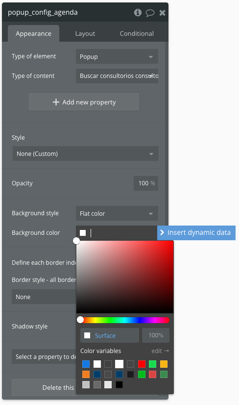

Another way to do it is by defining HEX colors in the database or in option sets, and when defining the element’s color, you use text as dynamic data color.
The first solution is simpler and will work for specific cases, while the second solution is more robust and works better for more scalable cases, such as the need for the user to define the application’s theme color.
