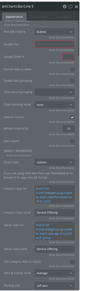

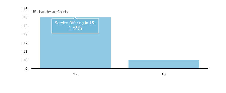

Thank you @ edwardbutcher fo this suggestion . i start using amcharts Bar/Line but is it possible if you can make a simple example of one chart because it didn’t show me the date value in the bottom axe while it show instead the value of "overall or each group " . thanks
this is some picture of about the issue
I have added an example beneath the previous…
Take a look here.
