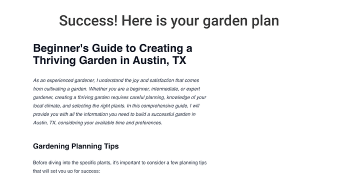

So I figured out how to get the data into the content so you helped me solve the markup part. My next problem is for some reason, it’s not taking up the full width of the HTML element. As you can see below the text is only taking up about half the allotted space.
It looks like the width is being truncated somewhere.

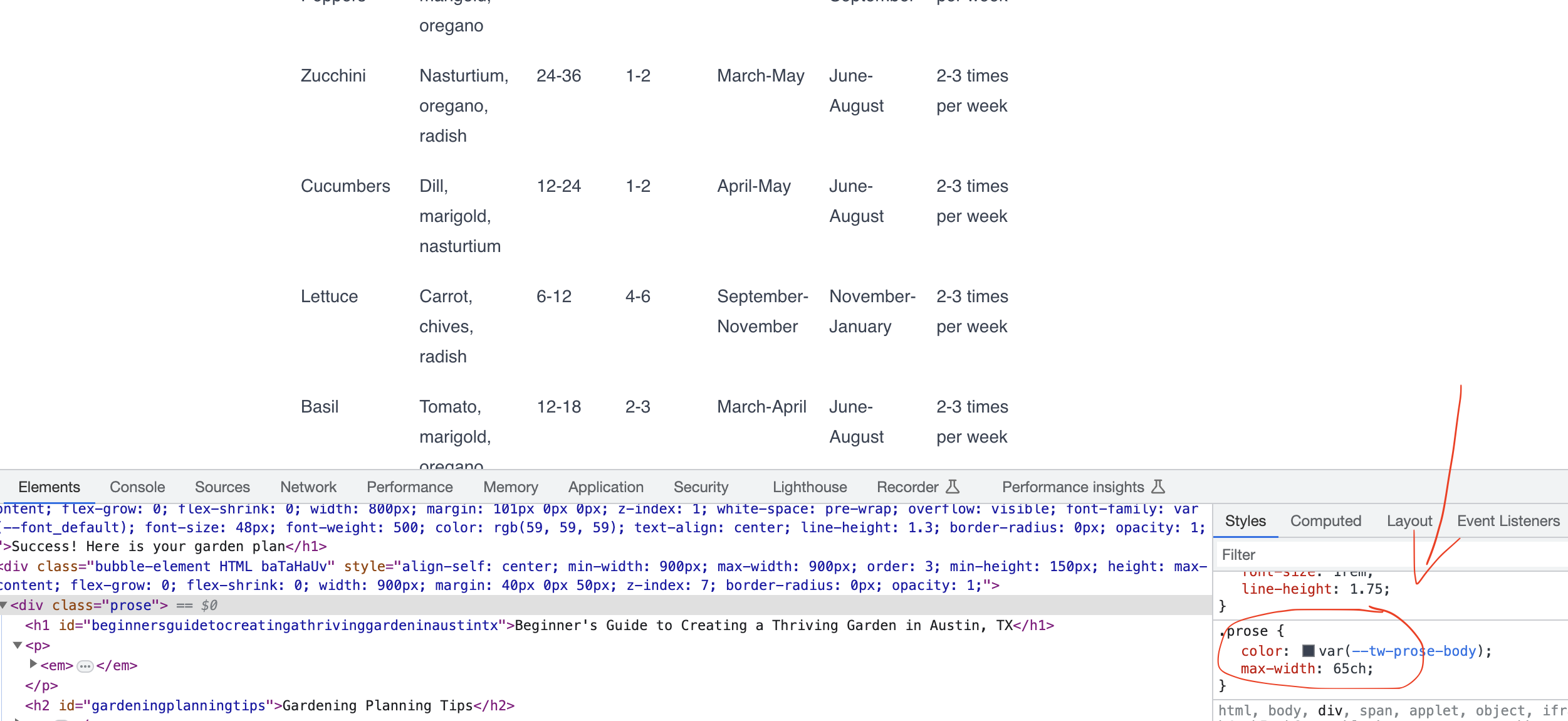

I ended up using the Markdown Pro plugin. I added the below code above the
tag in the appearance box in my screenshot above. This code fixed the formatting issue.
<style>
.prose { max-width: 100% !important;}
</style>
Hope this helps.
