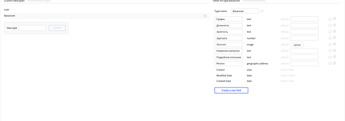

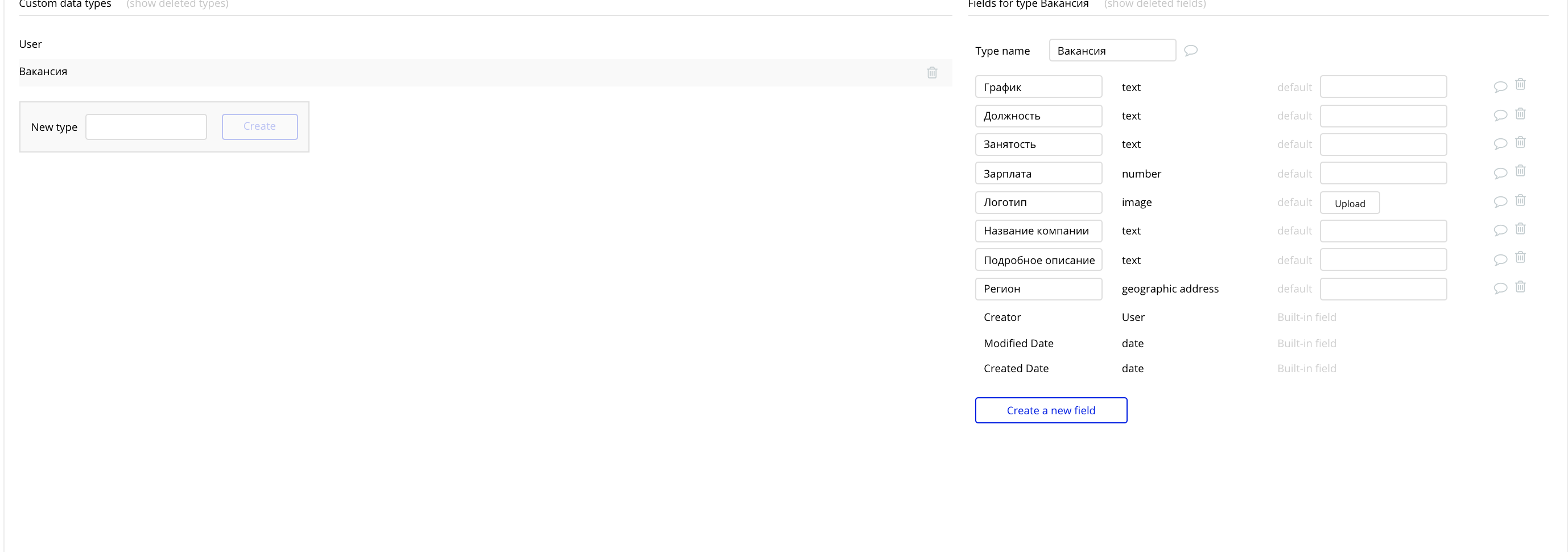

Here’s the parameters i have for the checkboxes if it can help somehow
here’s the data from data app

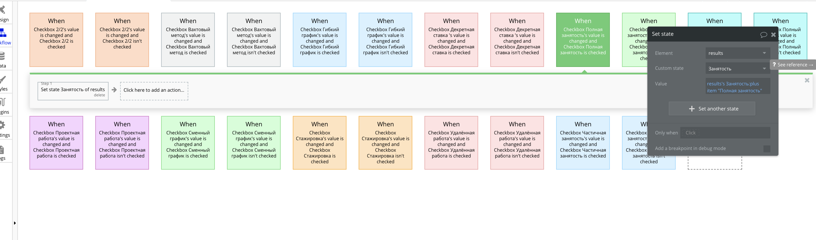

Then in the workflows for your checkboxes, all you’ll need to do is plus or minus them from that custom state, and that should do it nicely.

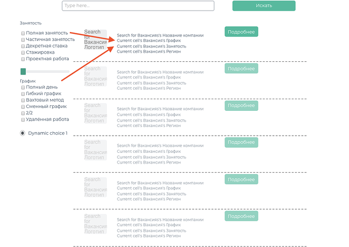

Screen Shot 2020-04-06 at 12.38.09 PM
Your organization is highly inefficient as you are doing 2 search for’s within the RG. You shouldn’t need to do any searches if you have your data set up correctly. But even with your existing data structure, put the image and the text into the same group and then do the search in the group, with each element using the parent group’s content.

as for plus-minus items : it’s already done and there’s no any reaction on clicking on them in preview

I think the issue is that your plus/minus logic is back to front:
If the value IS checked when the element is clicked, then you want to MINUS it.
If the value IS NOT checked when the element is clicked then you want to PLUS it.

Add a text element to your page and make it dynamic with the appearance of Result’s custom state. Then you can see if the problem is due to the custom state not being updated. If it does get updated then the problem is with the RG. If not, then the problem is with the updating of the custom state.
Than in preview the list of vacancies is not shown anymore and we see only empty space https://cheyruchey.bubbleapps.io/version-test/results/sample:user?debug_mode=true
As for the checkbox logic - honestly don’t quite understand why logic is like this
Would you be so kind to explain me a bit more in details ?
I’ve tried to make a dynamic text element and it shows up in preview
so when the element is clicked it goes like this:
when i remove the tick it shows in
if i put in RG the dynamic data NOT Current cell’s of custom state, but the result’s of custom state as in your shooting tip
so i change
this to image
than in the preview it shows up in the following way: clicked:
removed:
