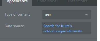

Where do you store data for the fruits? And why does it say “current cell’s text”? Where did that value come from? What i understand from “current text” values, its usually the data from what the user inputted. And in this case, theres no input box.
Fruits are stored on a table called fruits.
The “current cell’s text” is just a repeating group, but one that has a type of “text”. That way you can pull out the uniques, so you only have the set of colours that are stored.

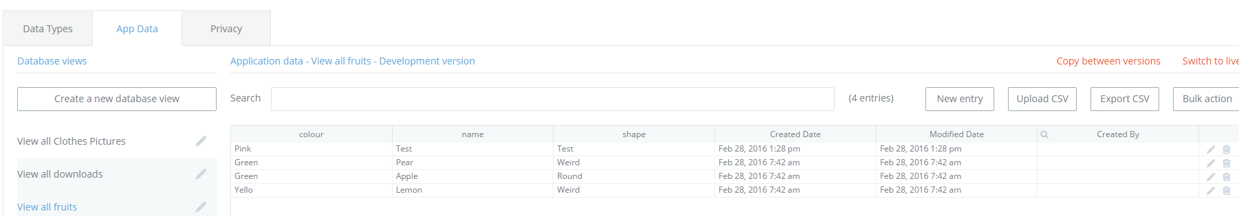

Where is the database of Bubble? can i manually add entries on that backend database? Im exploring the data tab but it doesnt show any of the entries i try to put on the “add entry” option. Also, i cant even see the “database views”
Under data/app data
Yes, you can add your own. Looks like someone added a “pink”.
That was me who added pink. I think bubble has a bug or glitch cause it doesnt update on me.
Also, i cant see the “database views” but i can add an entry.
Im guessing its just on my browser.
Anyway, i kinda get the idea now. I have a data type called People. And a field called “Type”.
I added a dtabase view. Then added entry under People. It should show on the repeating group the entries i added. But its not.

Never mind. Its showing now. Im just wondering why your repeating group is “text” and data source is from the databse. I tried that on mine but it says i should change the type of content to what the data type i wanna pull the data from.
Anyway, how can I put values on the checkbox? Yours do not have a value. Its just a check box. I need to have a value for the checkbox so it will filter the result on the main group (which is also a problem ill figure out later)
My repeating group is text, because that way I can make sure (via :unique items) that I only have one entry per “type”. So if I have 100 “Farmer” rows I only want Farmer displayed a single time, not 100 times.

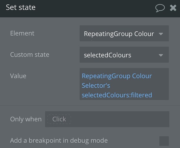

Hello @NigelG, I am trying to build the search functionality presented above, but i am failing to :filtered on state, doesn’t appear to select.
I created a custom state “Text”, is it right?
Thanks
@NigelG found it. When setting up a state, I should have selected display list!!
