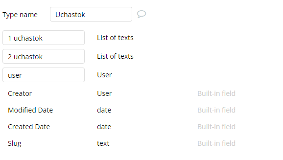

1 uchastok - 1 area
2 uchastok - 2 area

One thing I am not clear about how do you define addresses for the areas (area 1, area 2).
I mean each area has multiple addresses. Are you using option set for the area where address is the attributes as list type?
Or I don’t see any address field either in area data type (Uchastock).
You should build this thing first in this case if you don’t have any.

You need to change the data structure.
You do not need to create different fields for each areas/region.
1.Instead create a filed "Region Name/Area Name’ (whatever you like)
2. And a filed let’s say “Address” (list data types) - which will list all the addresses of that region/area.
