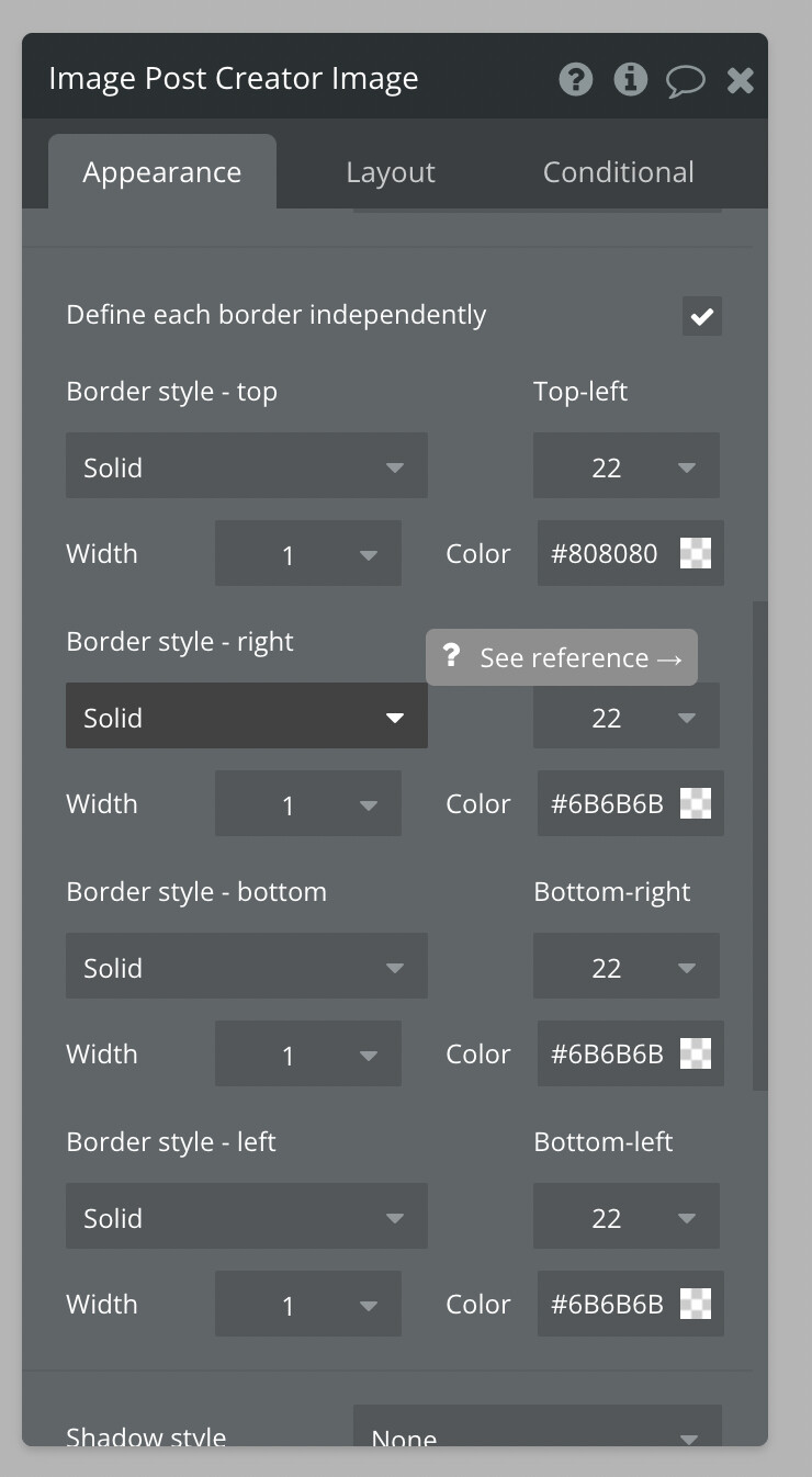

What worked for me was looking at the profile images here on the bubble forum that are round.
I used inspect element to see the CSS. I saw that to achieve the circular images, each border corner radius is defined independently and set to 50% of the width of each side
First, make sure the image element is square. I set the height and width to 45px.
Then set the border radius of each corner to 22 which is roughly 50% of the width and height of the element.
Resulting in a circular image!! :smiley:
