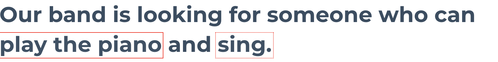

I am looking at the idea of a clickable text that presents an input for the user to complete when clicked.
Imagine the app displays the following text
“Our band is looking for someone who can play the piano and sing”
“play the piano” and “sing” would be clickable and when clicked it would produce an input where the user could type something along the lines of “I am available to play the piano”. When the user clicks again the input box disappears, the skill of playing the piano is added to his profile, his availability is also added to his profile.

So the user reads the text ad
“Our band needs someone that plays the piano and can sing”
The clickable attributes are “play the piano” and “sing”.

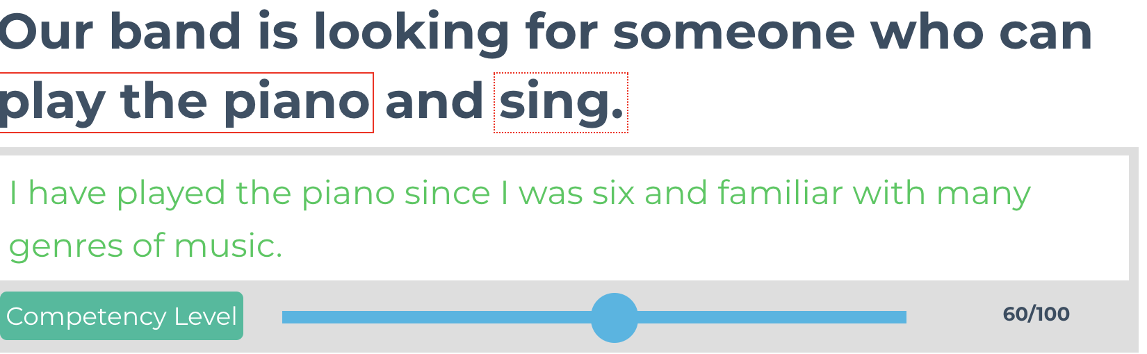

The user is able to click the attributes and input some information regarding that attribute eg. “I have 6 years experience playing the piano”
This information is then added to the users profile as a skill.
(I will see if there is another way to upload the pic now)
User is able to input info regarding that attribute and add a competency level, user clicks again and input box disappears, this skill and competency level is then added to users profile.

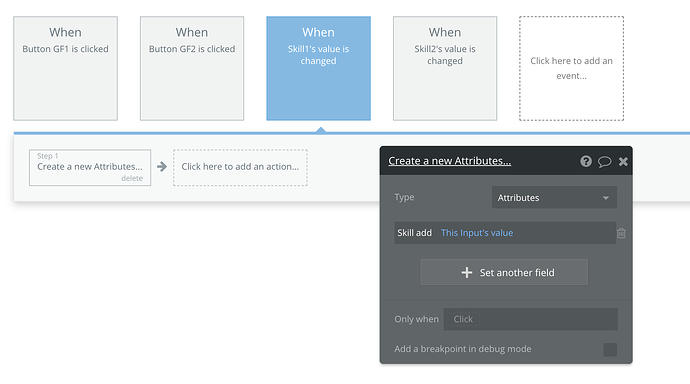

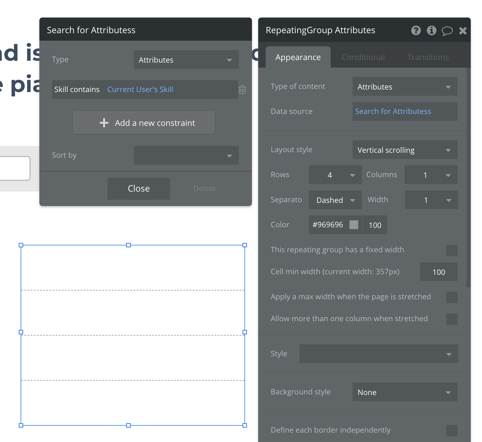

You’re creating a skill and adding attributes to it. In the repeating group, you need to reference the skill somehow. The way you’re doing it now means you need to say, “Skill is equal to this skill I created earlier.” The red box is Bubble’s way of telling you, “You need to specify which skill I should be looking for.”
Are you saving a Skill to the current user? I don’t think I see that step in an earlier image you shared. You create a skill > add result of step 1 to user in the workflow. THEN you can reference “current user’s skill.”
