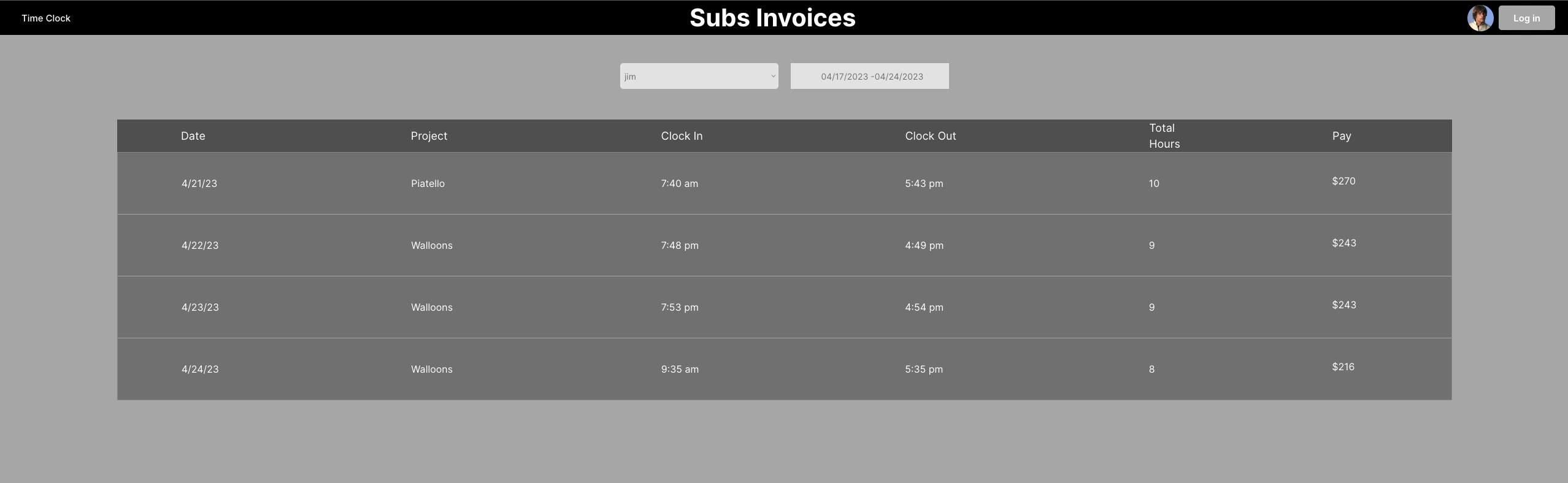

Now to my problem. I am developing an app for users to clock in and out that let’s them choose what project they’re working on. I have successfully created a page with all of the work flows for the end user. I have also made an admin page for admins to view the data in a repeating group filtered by user and a date range.
I would like to add an area below my repeating group where I can break the data down by project. Meaning for the currently displayed user it will display each job they worked at, the total number of hours for that job, and the total pay for that job for the date range selected. Below is a mark up of what I would like to do.
I spent some time trying to add another repeating group but I can’t figure out how to make all of the data add up for a specific project, it was listing the same project multiple times sine the user clocked in to the project on multiple days.
I just can’t seem to wrap my head around how to accomplish this. If anyone has an idea I would really appreciate the help.

Hi there, @acaudill… if I understand your post correctly, try a repeating group with a data source and text elements that look something like the following.
Oh, and because you already have a repeating group with the invoices, I believe you should be able to replace the search in my example with the repeating group’s list of things, and then add the :group by operator.

Thank you so much! That’s exactly what I needed to do.
