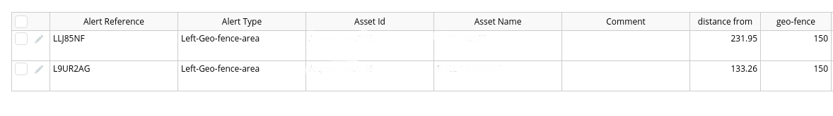

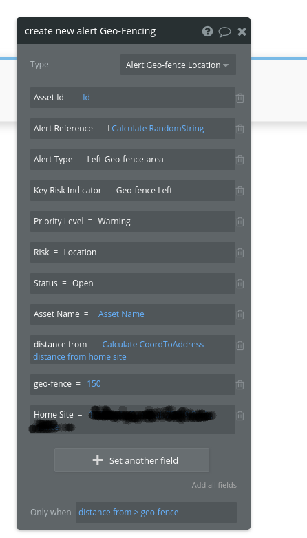

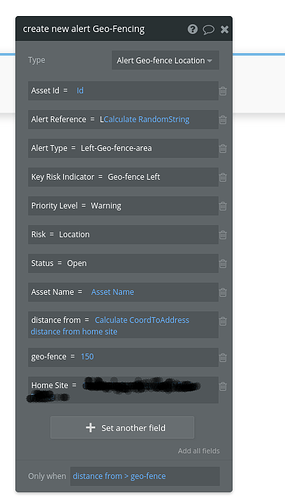

I hope you are doing well, I want to compare 2 numbers in one condition but it fails every time, I want to trigger an alarm if the “Distance From” value is greater than the “Geo-Fence” value, but it doesn’t work not.
If I remove the condition the entries are created. What’s wrong ? Thanks for your help.
Hi there, @kqkq… I could be off base here, but it looks like your condition is trying to compare two fields that are part of a thing that hasn’t been created yet. Try making your condition Calculate CoordToAddress distance from home site > 150 and see if that produces the desired result.
Best…
